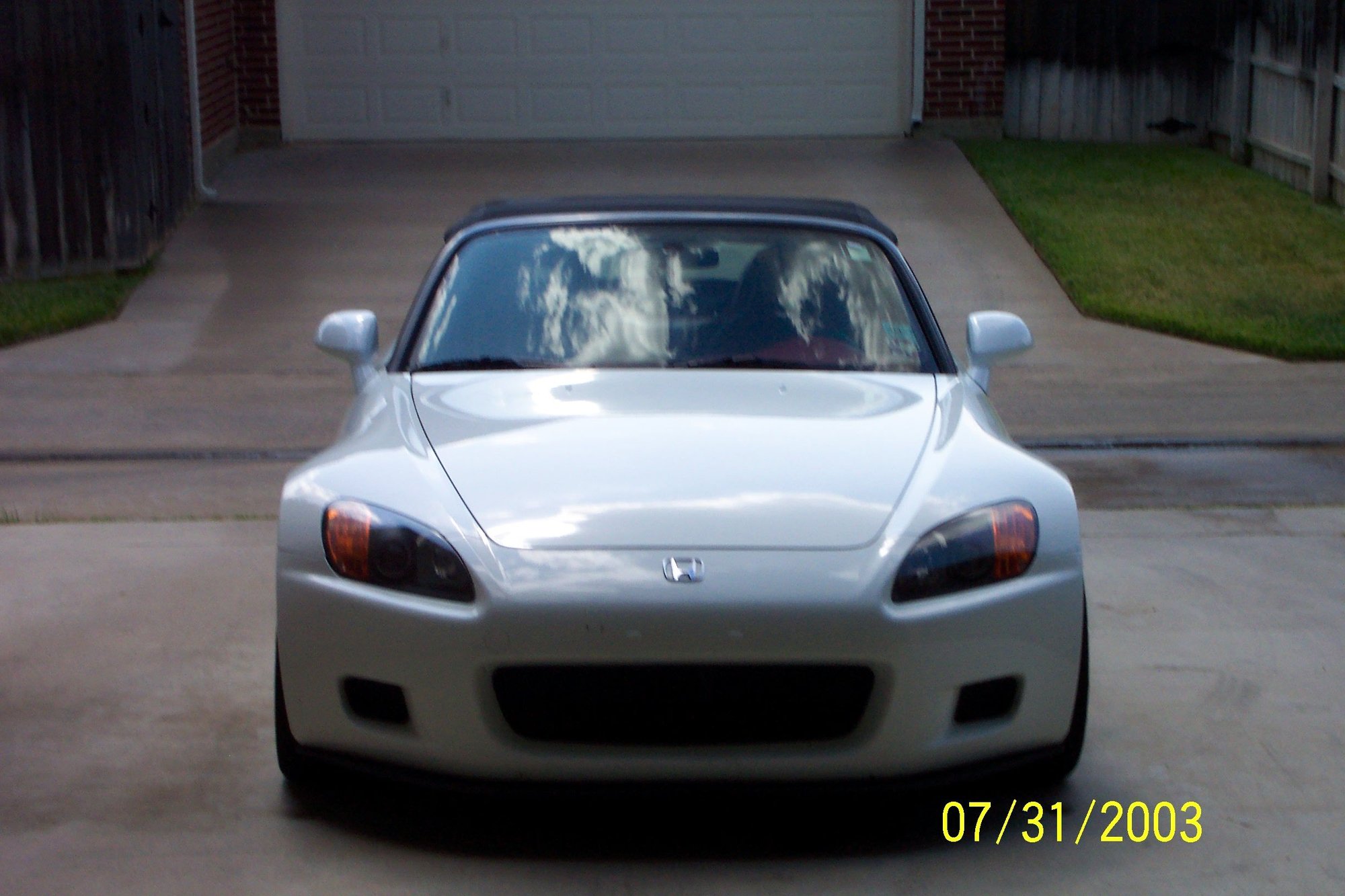

OK. Here is the final finished running product on my car. I started at 8pm last night and finished at 5:30 this morning. This is NOT a one man job. Lucky for me I always had one more person to help. The electronics are not as hard as many people have said. Follow the diagram not the instructions and everything will be just fine. The only wires you mess with are the wires going into the 25 pin, 31 and 32 pin connectors that run into the ECU.
It will be awhile before I write up some more install tips. The amount of time, effort, cuts, bruises and pain in my ass work that went in to this. I would consider doing an install for another owner in the area ONLY if money was involved, otherwise FORGET IT! We managed to install kits on 2 cars in 1.5 weeks and that was with taking a 2 day break over the weekend.
I also took the vafc out until someone can tell me for sure how to wire this up.
Regular S2K?
OR NOT?
