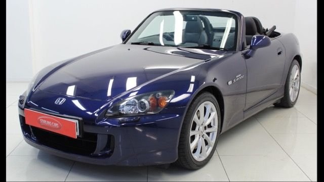

Bought my S2000 around October 2017, was actually without a car for two years before hand (living in central London) but mainly in to RS Renaults before hand (Megane 250 and Clio 172). Was torn between the S2000 and a DC5, went for the S2000 in the end as I was keen to try RWD and a convertible! Here are a few pics from the advert, haven't actually got round to taking any more as of yet, as the weather has been pretty shocking! It's a 2007, around 85k, and lovely condition inside and out.

Very nice and love the colour ( although I could be biased )
bring on next week with the good weather coming

It will certainly be nice to have some sun at last - only two roof down drives so far this year for me!
And yeah I love the colour, I should really do a better job of keeping it clean.....
