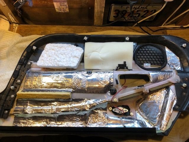

When getting the audio tuned at Studio In Car the other week it became clear that the door cards were vibrating quite a lot and causing a few resonances - time to add some Dynamat to the door cards too! Pretty straightforward:
Added some foam for a bit more isolation:
Haven't had a good listen yet but hopefully this does the trick! Next up was sorting out the subwoofer install which I wasn't very happy with. As mentioned previously I bought a sub box off eBay from the US, it's pretty well built but the fit isn't great and the carpet was black which isn't ideal. So, decided to make a top plate out of 6mm MDF which fits the carpet much better. After a little measuring this was screwed on and then carpeted in grey carpet - I had ordered a few samples off eBay and this was the one that matched best, so ordered a roll.

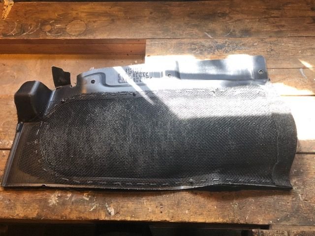

Haven't had much time the last few weeks but pretty much finished off the audio install today - the remaining job was tidying up the spare wheel cover. I wanted to make something that removed the 'bump' to give more space and also was breathable to allow the sub bass to get through to the cabin. Took me a while to decide what to do, but ended up buying a second hand wheel cover and cutting most of it away, leaving just a frame. Then got some steel mesh from work and shaped it to close off the panel, removing the 'bump'. Then punched lots of little holes all the way around the panel and stitched the mesh in with some cord:
I then covered this in the same carpet as I used for the sub box, the match isn't bad, looks better in person that in the pictures. Job done!

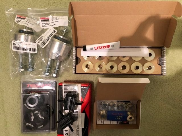

Small update before a big update in a few days - booked in at TGM for a clutch change plus a few other jobs:
  • New OEM clutch, remove delay valve
  • VibraTechnics engine mounts and Hardrace gearbox mounts
  • Tegiwa differential mount collars
  • Spoon subframe and steering rack rigid collars
  • Bit of an alignment tweak, a little more camber both ends
Looking forward to seeing how the new mounts and collars turn out - I have quite a lot of drivetrain 'slop' at the moment so hopefully this tightens things up a bit! Will report back with feedback which may help someone one day!
