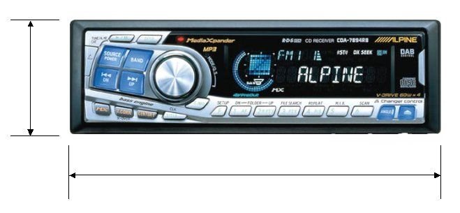

is the apeture for the standard HU the same dimensions as the overal Alpine HU dimensions (see pic)

yep (ish). The black shroud neatly completes the install. The extreme dimensions you depict above is not the chassis size, thats including the plastic surround. But it all fits fantastically.

Yep, CC's opinion seconded. The only hassle I had was fitting the wires behind the HU.

thanks guys, I should have been more clear, the apeture in question is the one that you remove (the door/plastic frame bit that fits around the stereo). But yes, I've seen a few pictures and it fits very nicely.
