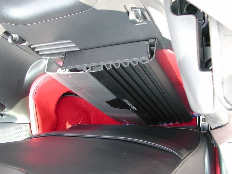

pic for a few ideas

Nope the amp doesn't run hot, it hardly heats up, I made sure of that before I fixed it there. Yes the back of the seat does just touch the top edge of the amp. I now have some velcro on there to protect the seat.
The bottom picture is my old MY00 car which had no door tweeters as stock. A pillar mount is a better place providing you set it up right. If you look at the first pic that is my current 04 car and the tweeters are in the stock door card position. I can hear the difference so I am going to get a couple of A pillar trims and mount them flush at the the bottom end of the A pillar.

Believe it or not that one behind my seat does 5 channels
