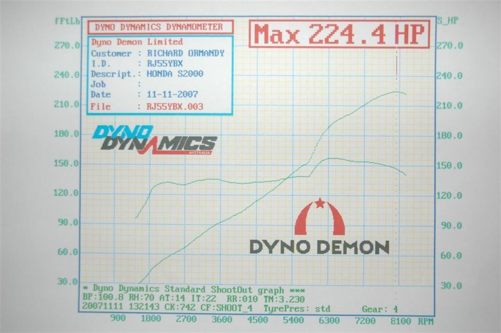

Yesterday I went down to Dyno Demon in Wirral to try out their Dyno Dynamics rollers, I have been told these are the "daddys" when it comes to rolling roads
Here are the results.
(click pictures to make them bigger)
Air Temp was 14 degrees.
Intake Temp was 22 degrees. (measured at the filter)
~16% Drivetrain loss.
Engine mods are Berk decat, Buddy Club dual exhaust and K&N FIPK.
The power at the wheels was what I expected, the power at the fly seems a bit low though from what other graphs i've seen. They calculate the drivetrain losses at this place not run them down so it's supposed to be more accurate

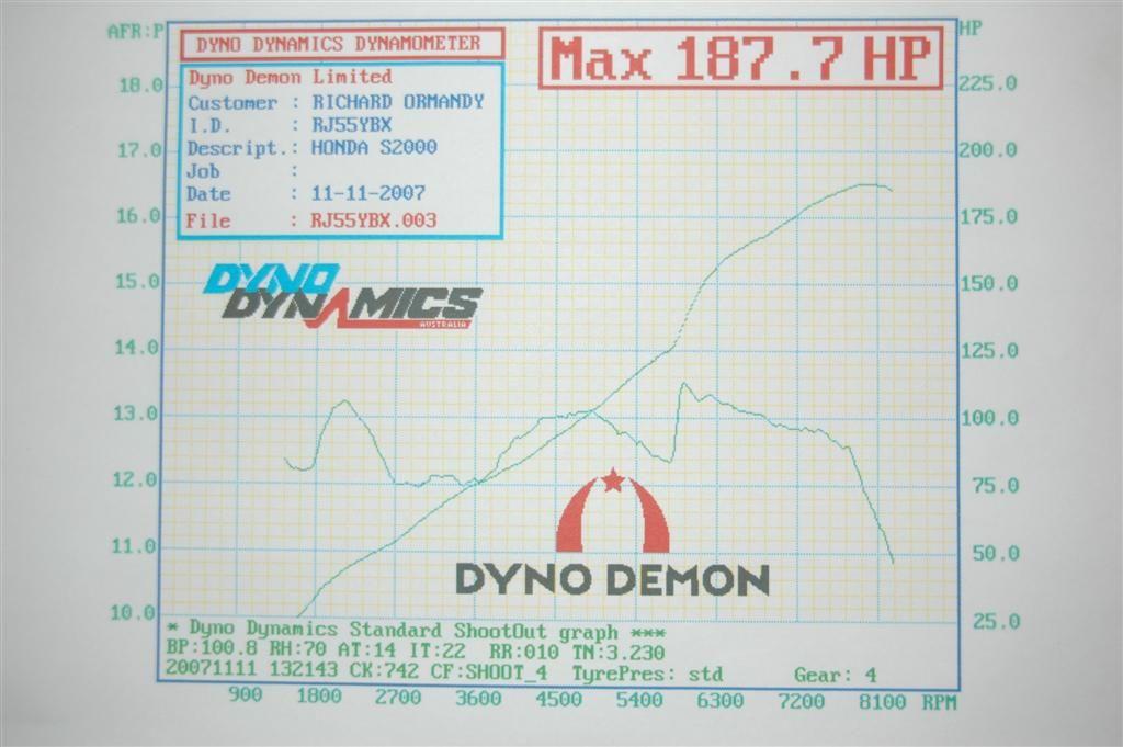

One other thing I noticed is the AFR is a bit lean in a few places, is that normal with light engine mods?
Thanks
Rick

I would have expected a a few more bhp at the wheels ...... over 190 at least.
You can ignore the flywheel figures, these are a bit of a guess.

I did think that it might have got a few more but i've never seen another S2000 on the rollers so I've no idea really.
I'm going to change the plugs and clean a few sensors up incase they are dirty and try again when I get chance.

Your AFR is very odd. It should be a fair bit smoother and dropping to very rich at max rpm.
There is an 8 degree c differential temp on ambient versus intake, which on these dyno's can screw the results up. Alan from WRC tech was explaining to me how the maximum they allow is 5 deg c otherwise they dont count the result as genuine.
I would ask why they only took it to 8000 rpm though

Any ideas why the AFR is like that MB?
I went with the 200sx lot and their intake temps were quite a bit higher than mine so I guess it must be ok?

mine did 181 whp on dyno dynamics, at stage ^ in the staes a few weeks back, i did not think it was too bad for 125k motor
mase said it was not to bad considering age etc, he said its normaly around the 187 mark, but check out the florida forum they have just had a dyno day and there are a few results on there, some low and some very high, scroll through pages and some of the results are there

Strange curve doesnt look too bad, better than what mine was!. Im going to get a second hand VAFC2 and help install and tune that with a fella i know.
I went on a dyno about 2 week ago, the guy said it reads slightly less than other dyno's. But of course some dyno's read differently than others.
If its a yank dyno then expect 200 @ wheel stock
I got:
190.8 @ the wheels
236 IIRC at the fly
