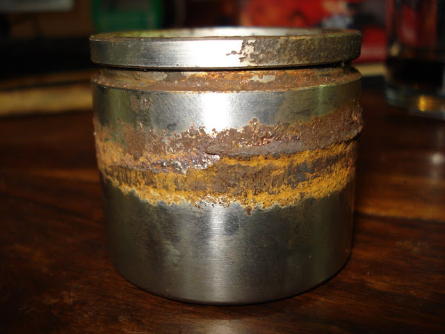

I've ordered a pair of the ebay calipers to check out how good they are - if not happy with them i'll just send them back.
Although from the sounds of it its worth checking if it's the sliders that are the problem? I thought on the S2k's it was the pistons which corroded? (as seen here; http://lh6.ggpht.com/_sb14GlBDX2I/Sv...0/DSC02058.JPG )
Sorry slight tangent, sounds like alot of heat in your brakes if the wheel has seized on and won't shift! Hope the wheel bearings etc are ok.
It'll be obvious if it's the slider - just take the caliper off and see if you can move them. I've had the sliders stick on one, but it's more often the pistons.
