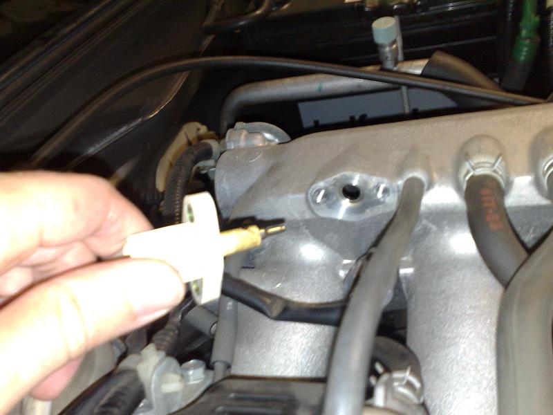

7) Air intake temp sensor - Now I have ruled out all the easy ones, im starting to look at engine sensors - these are what I find to be the majority of all problems - novelties and gadgets! The AIT is an easy thing to remove and clean. It could definately be a cause of all the problems. The AIT checks the temperature of the air going into the engine, and provides a signal to the ECU depending on what it sees. The ECU uses this to retard and advance igniton etc, so if its reading something funny, it might be causing the car to hold back.
Normally I would check and monitor the AIT signal and ignition advance but I haven't got a reader or software for the S
So I removed it and gave the tip a clean Be very careful with it! I used a soft cloth with some electrical cleaner on it. It was quite oily - but prob not enough to affect it but we shall see... it lives on the manifold back from the throttle body.
I am just off to try it! Bear in mind that after correcting a sensor fault, it can take several miles for the ECU to pick up on it, depending on the sensor. So you can either reset the ECU or drive around for 10 odd miles and let the ECU do its thing. Im going to drive it in this case.
