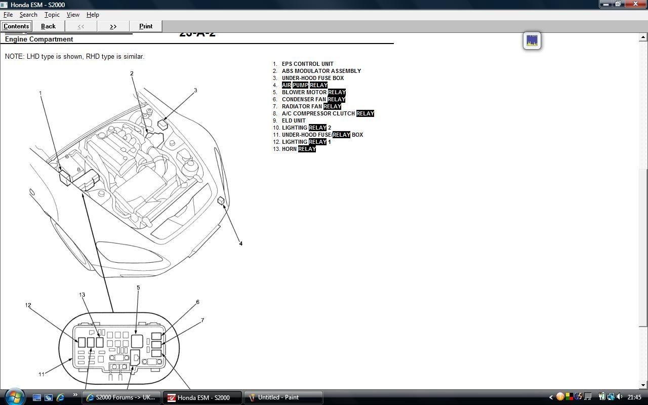

great news, so just need to find a relay and replace it and see if that works?
Old Jun 5, 2008 | 12:41 PM
  #24
RISLAR's Avatar
Joined: Nov 2007
Posts: 4,211
From: THE LAKE DISTRICT BABY!!
The relay is situated at the front right hand side behind the bumper as you are stud in front of the car, it is just below the solonoid next to the pump.
Its is a bumper removal job i'm affraid! it might be better for you to take it to Honda as this could be a difficult job if you are not handy with the tools!!
Heres the pic:
