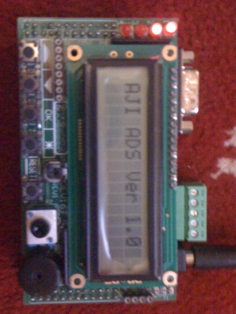

I wrote my own program on my mobile phone, to read codes and trend info like coolant, ignition timing, mpg, o2 sensors etc.
You wont be able to pull ABS codes etc, actually i need to look into this if its possible, but there is a reader for £55 on ebay that would be worth the extra £25 more, as the dealers have you over a barral. A snapon reader didnt work with my S to pull an ABS code.
Actually my current project is below...Scanguage type reader but better, with more functions and possibilty to read ABS etc if can figure it out.
Its for OBD2 and serial based ECU likes AEM, DTA etc. It will mainly be used in my car and cars that have had engine swaps (dashes dont work), turbo, showing boost, wideband etc all in one unit.
