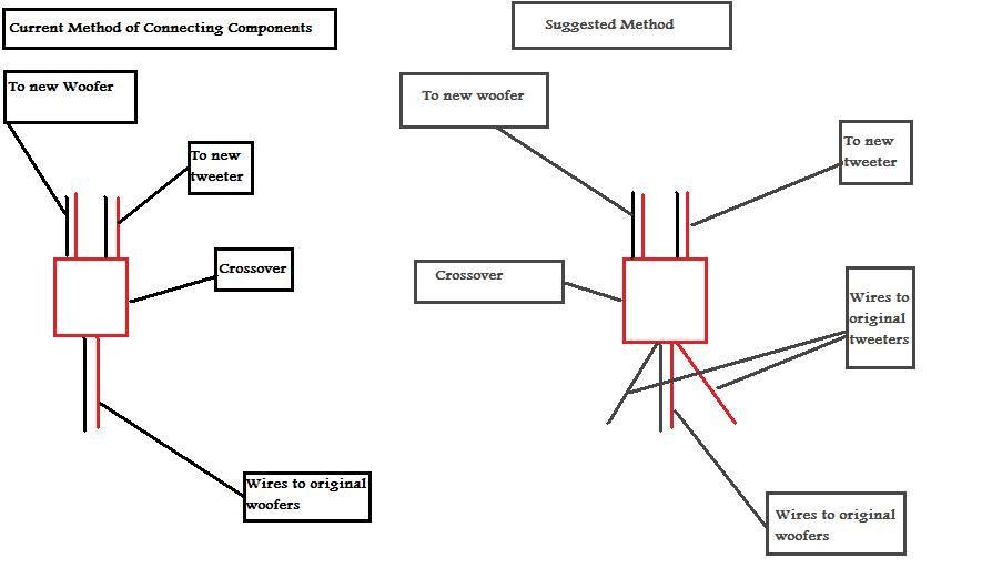

The current plan for wiring in the new components is to take the existing feed to the current woofers and use this as the input feed to the crossover.
I was wondering if there would be any benefit in utilising the input feed to the current tweeter as well by joining this together with the woofer input, the reason being this would provide 2 speakers worth of power to each crossover input rather than just 1 speakers worth.
Quick diagram of what I'm suggesting below:

Someone else will be better qualified to comment on the OEM wiring arrangement, but I suspect that the OEM components will be linked to a crossover somewhere. This may be a separate crossover box, but is more than likely contained within the OEM woofer.
Where does the OEM tweeter wire run to? Is it connected to the woofer?
I'd be very surprised if the tweeters are connected directly to the head unit (this is known as bi-amping btw)
Bi-amping, which is what you are describing, is beneficial, but is dependant upon having 4 channels of amplification.
In my setup, the left and right channels are fed at line level to the 4 channel amp. The amp then sends "2 lefts" and "2 rights" to the crossovers where the frequencies are filtered and thus you get the benefit you are after.
However, if you are using the OEM HU, this is an unlikely scenario.
I'm sure someone with better experience than me of removing the OEM speakers will be able to help out a bit more.

In that case, the only way that you could benefit from bi-amping would be if the tweeters have been wired to the "front" channels on the HU, and the woofers to the "rear" (or vice versa).
Try adjusting the fader and see if that affects the sound. If it does, then a bi amping solution is in place.
However, there must be some sort of crossover somewhere for the components.
Can you tell us what HU and speakers you have, as it'd help.
