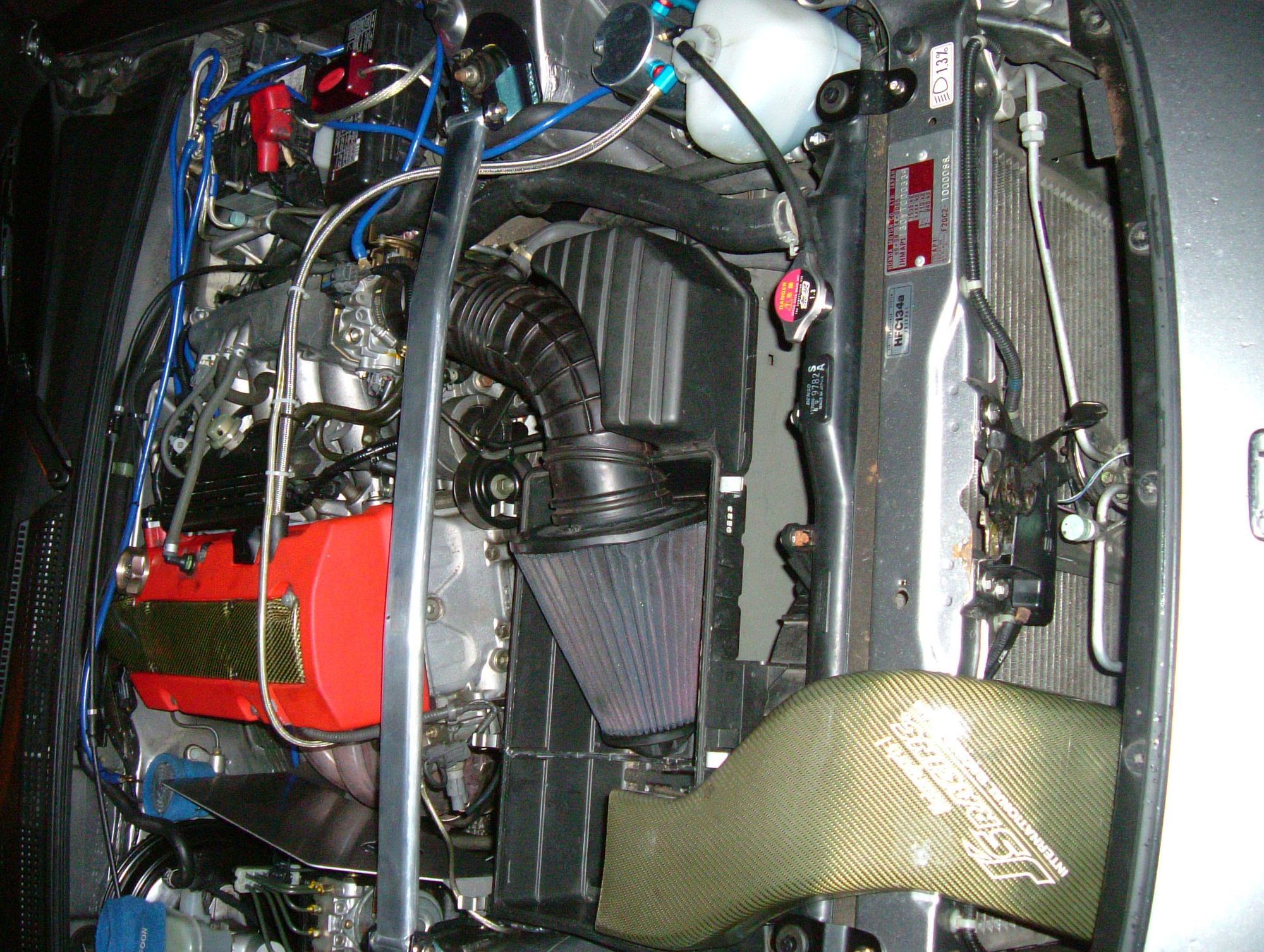

Thanks for the info. I do have a catch tank (cusco) it was one of the first mod's i did, there is a plastic sight tube on the side the is no sign of oil build up in there.
The plume is visible, the missis spotted the smoke when she was sat in traffic for a few minutes, she pulled off and looked in the mirror to see the smoke. Then the missis dad was following me yesterday coming up to an island going down the gears and again a plume of smoke, today missis driving car with me following again she was going down the gears and once again a plume of smoke. It is quite intermittent. The problem has not altered the performance just a bit unsightly and its using a bit more oil than normal. The pic is quite an old one so don't take the piss to much, the catch tank is behind the expansion tank.
