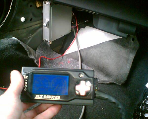

What amazes me is that they said the ECU pins were corroded? The ECU is inside the passenger footwell, pointing sideways, and unless water was tracking through the grommet in the footwell, I can see how they would get wet? Did they show you it?

I wonder if the corrosion had been going on so long that it had made it's way up the loom wiring to the pins - only explanation I can think of. They did have problems with water ingress on the passenger side of the car, where I think there is a harness that goes down to the exhaust or somewhere else. It could be that there was moisture in the that area - I never carried a passenger, so might not have been aware of it. They did try to fit a bit of plastic in the corner of the engine bay to stop the water getting in (after speaking at length to HUK), but it was never going to fit very well (siliconned in), and I don't know how effective it was.
