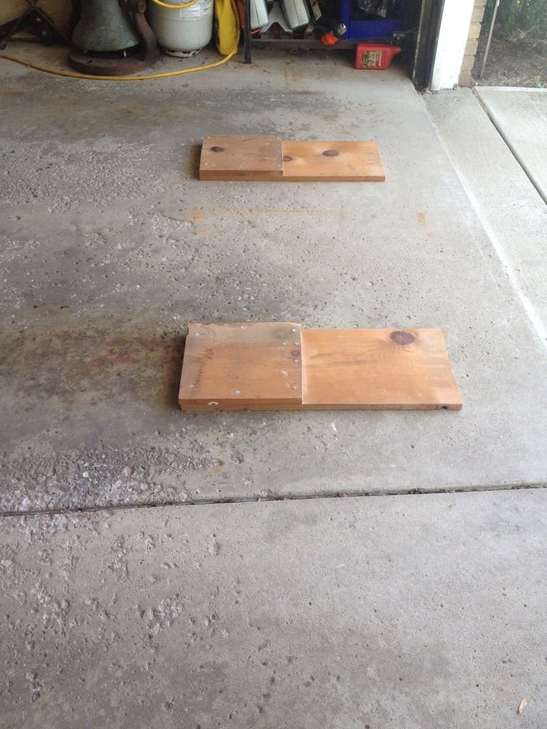

You'll probably need the car just a bit higher to get even a low jack underneath. I need these for my stock height car. Nothing more than 6 feet of scrap wood shelving cut into 2' and 1' sections and nailed together with flat top roofing nails.
-- Chuck
