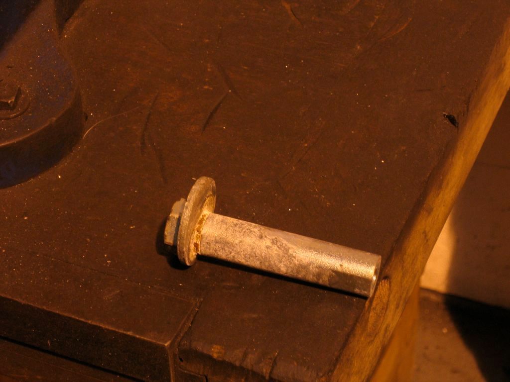

Seems to happen to most, unless they've been greased. This picture is from one of my FNS bushes (can't recall which) and as you can see it's starting to show the signs of corrosion. The thing is I'd been driving the car for 6 weeks from new and it was starting to go.
