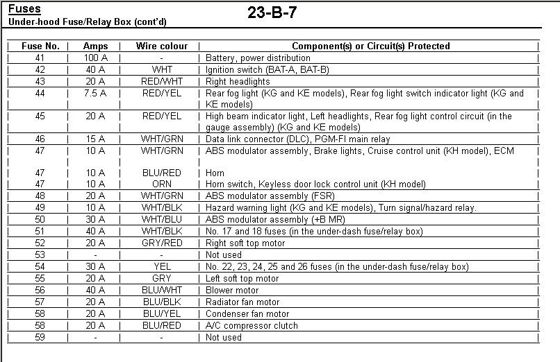

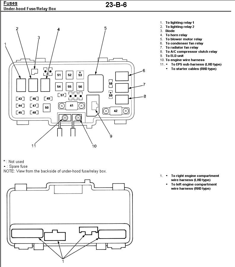

With reference to the FAQ, which specifies that for the hardwiring of, for example, a radar detector, fuse '42' (40A) is specific to the ignition switched contact under the dash.
Which fuse is fuse '42' and where is it located? The reason I need to know is that I've made myself a cable to enable me to hardwire my Origin b2 but I'm not getting any power from the ignition switched contact and I need to make sure the fuse is OK before I start pulling my cable apart checking for poor contacts etc

Fuse 42, bottom right top pic
