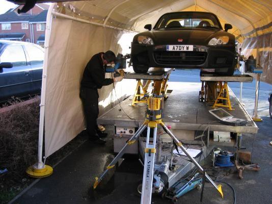

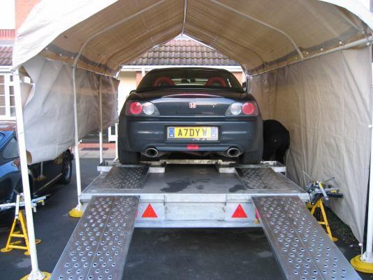

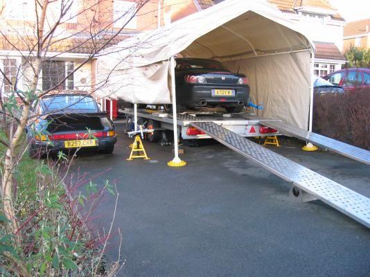

Getting set up 08.15 in Chris's driveway
I thought this was some sort of mating ritual but Chris assures me its to settle the suspension

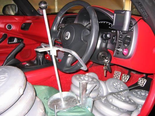

This was to replicate me in the driving seat. Not much of a likeness but neccessary to set the geometry up accurately

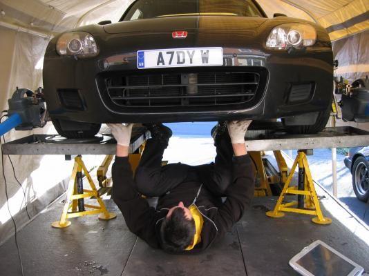

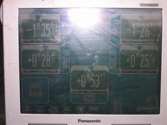

Chris getting the base line from the original settings so he can see what needs to be done

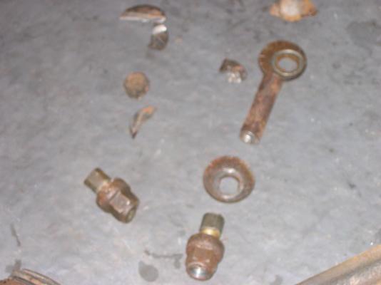

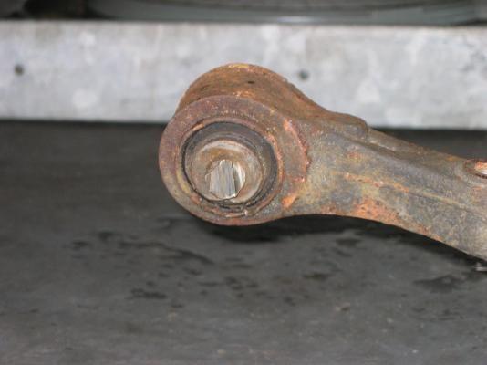

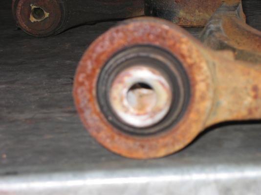

Some examples of "Carnage" as Chris puts it, supplied by previous customers

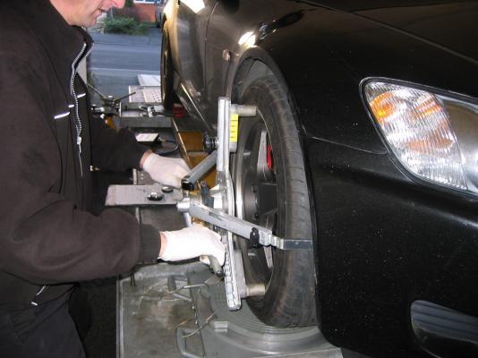

Following the base line recording Chris then firstly set up the back end "All Greens"
The rear end of the car did'nt take Chris long to bring within specification but that wasn't enough for Chris. He's a perfectionist and only "cock on" will do for him.
The front end however was a different story. The nearside castor and camber were both seized. Chris managed to free the castor bolt and sleeve but it didn't look like the camber was going to move.
Following on from another cuppa and some sausage sandwiches supplied by Jane. Chris had another crack at releasing the camber bolt from the bush. After snapping two extension sockets (one of them snap on) he finally got the bolt moving and proceeded to complete the setup on the front end of the car. Again massive attention to detail to get the setup as accurate as possible.
