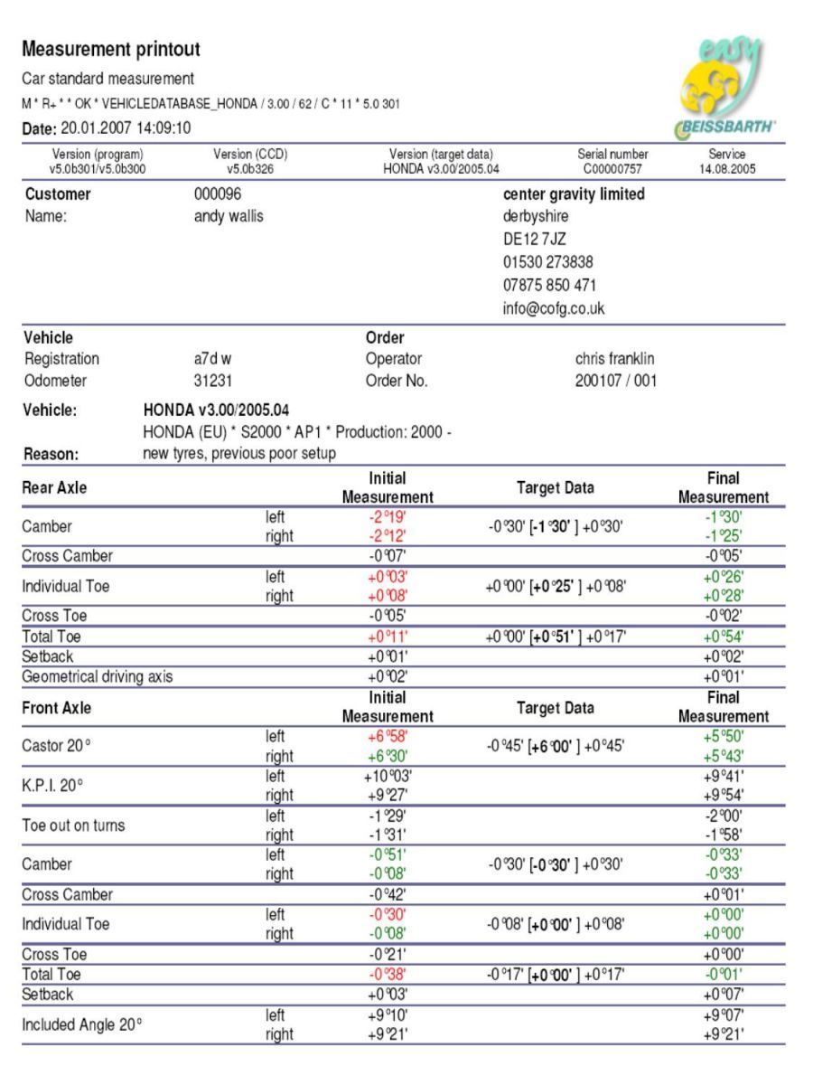

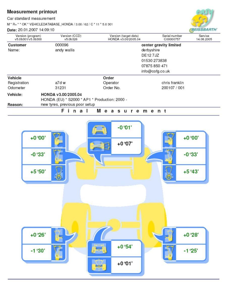

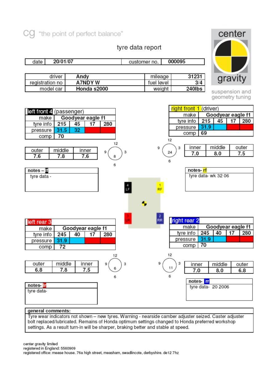

Ok, so heres the reports sent through from Chris, click on them to make them bigger.
Tyre Data Sheet after completing a full and detailed inspection of my wheels and tyres. They are all new so no surprises there
Measurement printout. All the red digits are the base line out of spec settings. Final measurement settings all in
Pictorial Measurement Printout
Cheers Andy
