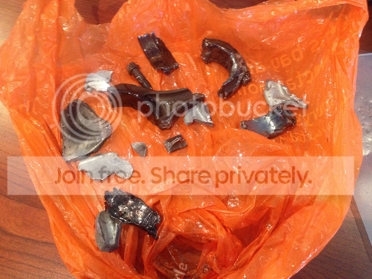

Be interesting to see if there is much play in the little end bearing of the detached piston.
I had an oil pump problem on my 06 engine at 17k miles. This resulted in scored bores and worn little ends. The resulting rattle sounded just like a TCT problem.
Honda replaced the whole engine under warranty at the time.

Ill give it a jiggle (technical term) tonight and see if there is any play.

Mileage on the engine was 78k
From showing tom (TGM) the rest of the con rod he straight away said he was almost certain that the con rod wasn't secured to the crank properly when the old knocking bearings were replaced by honda. This working loose and ultimately shooting out the bottom of the sump.

As promised, a few more pictures of the strip down.

The crank has had some serious heat to turn it blue, maybe from this time or leftover from the previous problem, loads of avenues to explore and lots of dead ends with it going twice

As Dave , Ray or what ever his Monica is , said that crank journal is very blue and clearly seriously overheated.
Just a thought, I wonder if the new shells that I presume Honda fitted were the correct size or correctly fitted resulting in a very tight bearing on that crank journal , pick up, over heating subsequent failure of the con rod etc etc
I think you're possibly right.
The bore isn't as scored as much as I'd first thought, so pick-up looks less likely. More a mis-aligned slug, when it was batted upwards & (gently) bashed the exhaust valves, probably as the big-end shells disintegrated.
But it's very hard to ascertain what's new and old damage. Apart from the journal face, of course!
