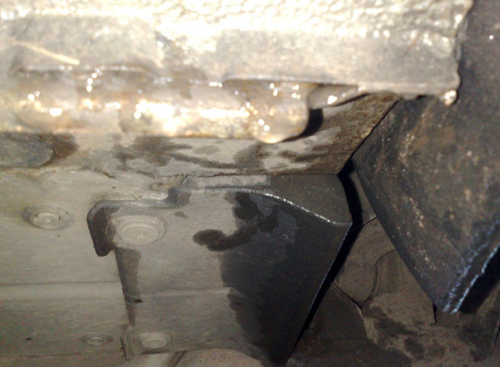

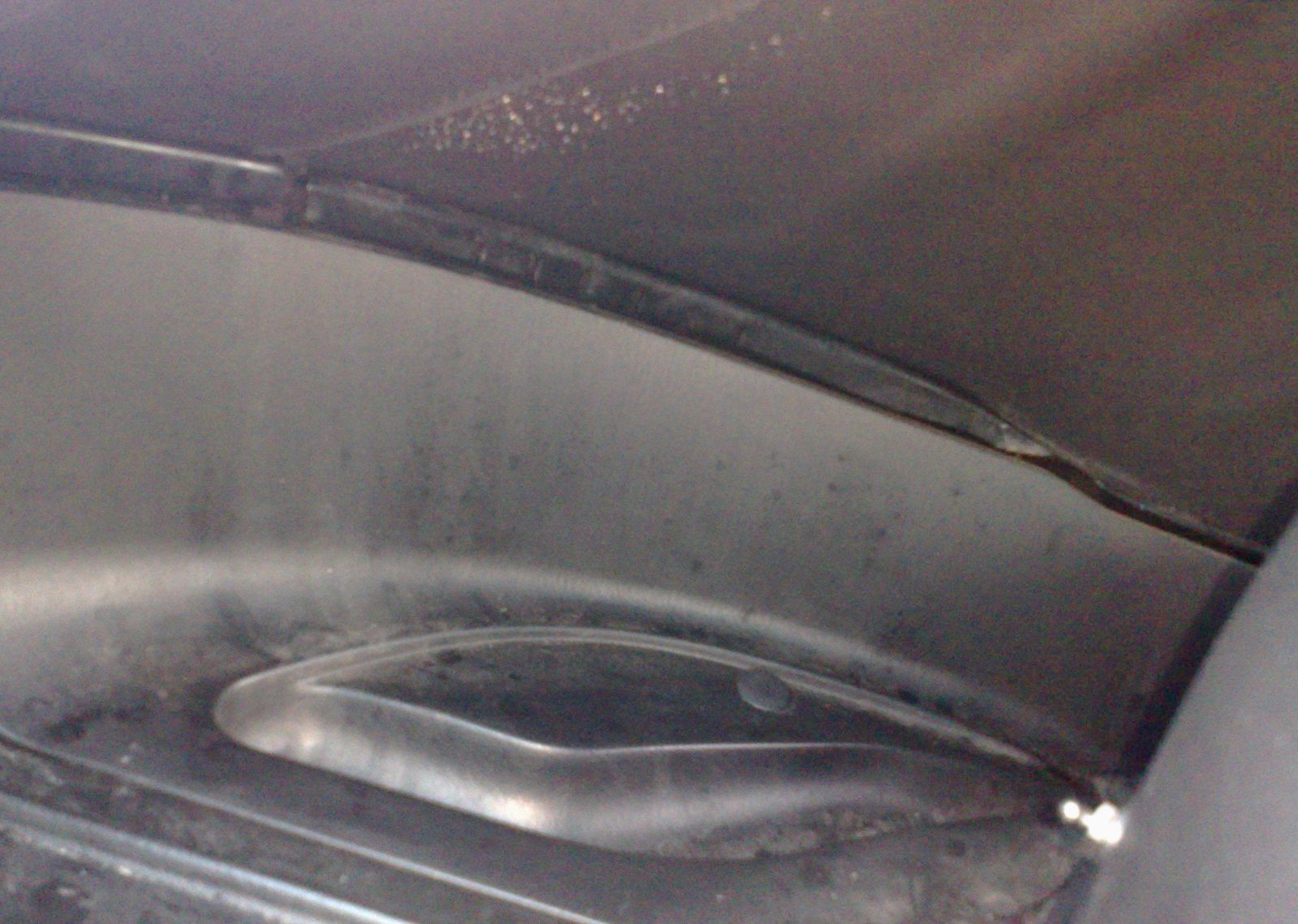

So a few days ago i took a few pictures is was very cold and the car had been sitting for a few days gathering frost etc. I have posted these pics just so i know that I'm looking at the correct items people are pointing out.
First, Steven is this is the wiper blade thing you were on about?, its securely fixed in place.
Whilst in the back the brackets did not look like they have butted up correctly, dont think thats a problem though?, the roof fitter must have damaged a few of the clips (understandable), which i will replace when they come through the post.
Is this the wing liner you are on about?
Rear mudflap, any chance anyone could point out the drainage hole underneath?, because of the way water collect pipe bends i cold not put the wire dont more than a few inches
Thanks all.

Thats the drip tray liner, yes, but not the rubber bumper.
The large rubber bumper in the pic is what is up against the soft top once stretched.
I have another one glued on more forward where the gap is with the roof up.
Not sure how much difference it makes though on its own, but without it I guess the water can more easily find its way behind the drain buckets.
PS my rear parcel deck looks the same, always wondered if its normal or since it was out for a repair?
