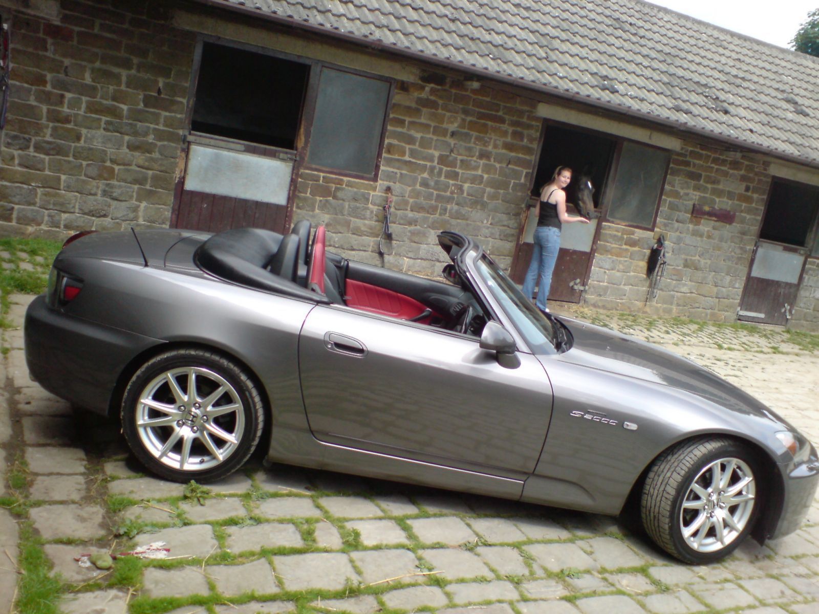

Before

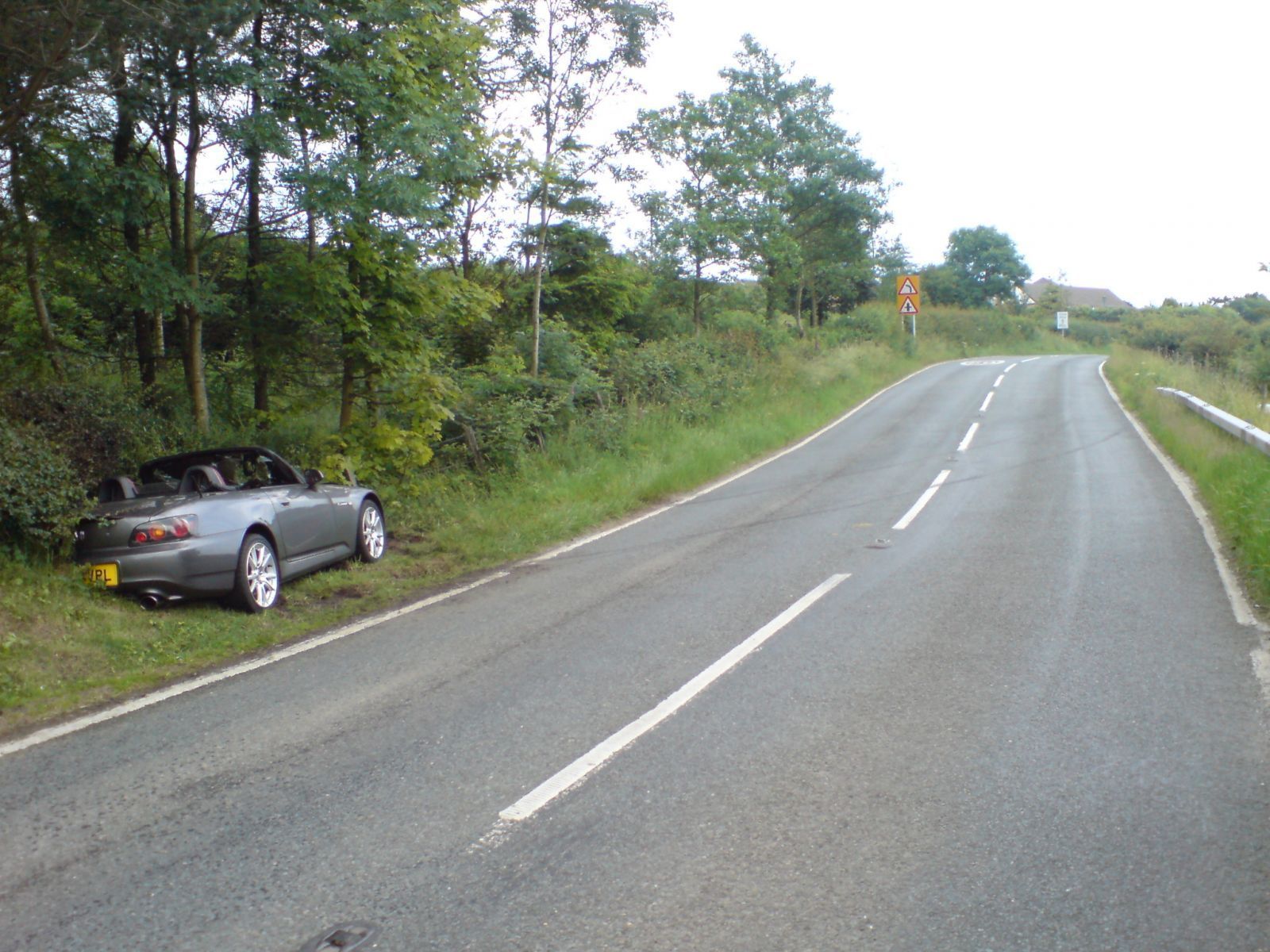

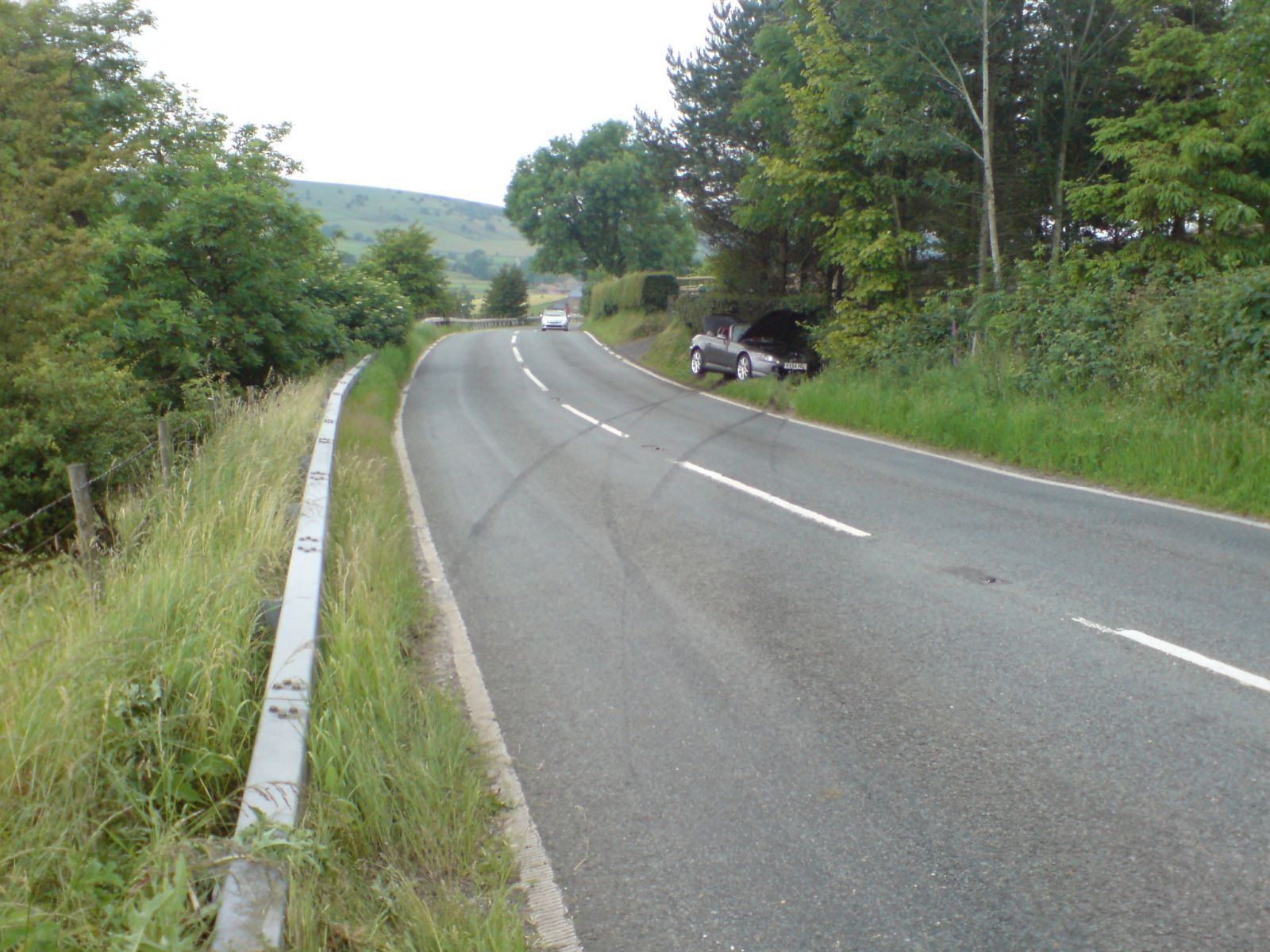

It was July last year, a beautiful day, out for a spin with “our lass” on the Buxton / Macclesfield Road. I had been driving enthusiastically but slowed for walkers. Back end stepped out caught it and went to far the other way. We hit the hedge about 10 - 15 mph, then our S started smoking from the top of the bonnet. 10 minutes later, she was well alight. 25 minutes later the fire brigade arrived and turned her into a hot tub with 4 wheels.
I have crashed my fair share of motors when I was younger and always held my hand up. But this one ???
Serviced 6 days before at G Lamb Chesterfield – My best guess is the oil filter leaked oil onto my back tyres and manifold. It’s the only way I can account for the complete lack of grip at the rear, then catching fire.
The walkers we passed reported thick black smoke coming from the rear of the car.

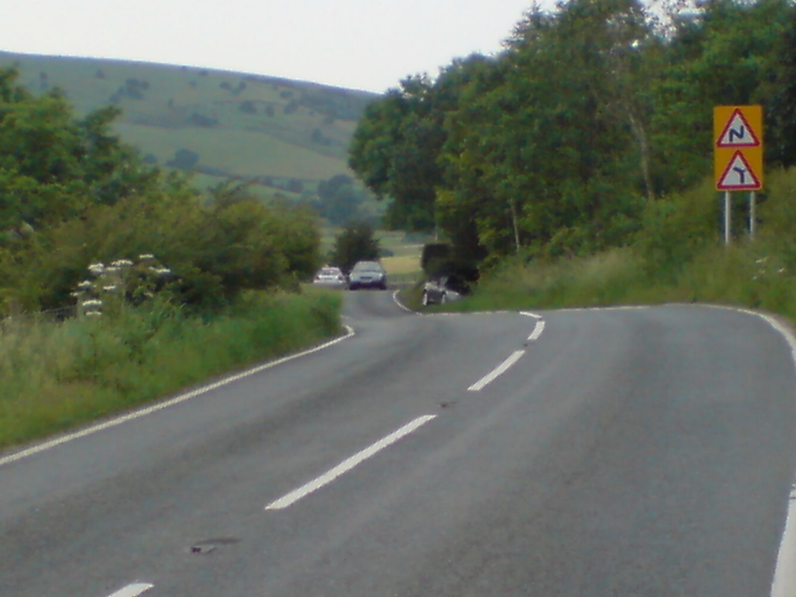

The Road
The skid, on a nothing of a corner

You say nothing of a bend but that crest would of definately shifted the weight.

I get shouted down, but peeps need to understand the dynamics of this car - it is not conventional in any sense of the word and needs to be treated with a great deal of respect.
The weight split is 50/50 but the engine, the bulk of the weight up front, is located just behind the front axle (FMR). Lift off oversteer is a fact of life with the car and once the pendulum effect is underway it is nigh on impossible to retrieve.
4 wheel alignment and good tread depth on the rear is very very important.
I started an excellet thread on the main forum. It's definitely worth a read if only to try an understand the dynamics of the car and the effect throttle position has on the way the car will behave.
I've had mine for 2 months or so and in that time there have been just shy of 10 cars that have been written off, most spinning off the road backwards.
