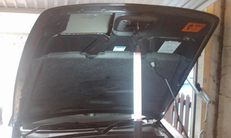

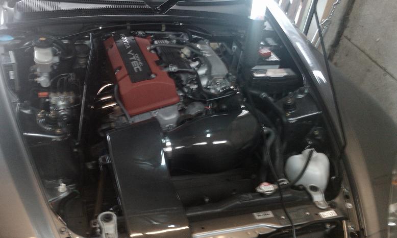

Right got the J's intake on at last. Not I job I would want to do again, and I really hope it's bloody worht it!
I had to cut quite a bit off the front of the intake snorkle to get it to fit the 04 bumper, and had to cut a fair bit out of the bonnet.
Here's the bonnet surgery. I have some touch up paint to go on there, and then some nice seal material which STiv5 recommended Should be here tomorrow.

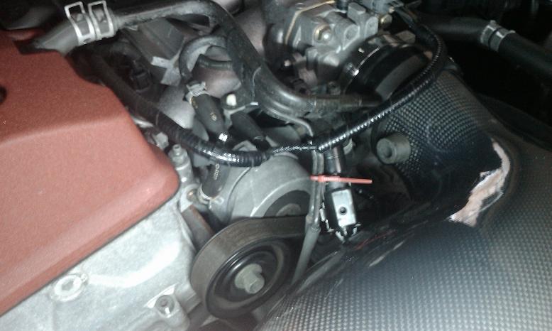

Here's the intake installed..
The only problem I have remaining is the coolant pipes and engine breather hose. I have some new hose to go on for the breather and the vac lines, so that's ok, but the 2 coolant ones have to be replaced too and I don't have any as they are a bit bigger than what I have You can see where the OEM breather pipe doesn't come anywhere near the J's port.
I've tied off the vac solenoid for now and the car won't run until i've fixed the vac pipes etc.

What did you cut the bonnet with
Hope the intake was cheap, what happened to the top of it?
Looks like it might have been rubbing on a strut brace?

Adrian, trusty Dremel! It's actually very neat. I used masking tape as a template and cut straight.
That is a reflection in the top pic, it's in perfect order
