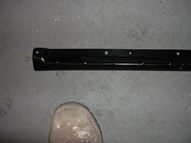

There is a bracket on the back of the number plate holder designed to stiffen the bumper. It is up turned and fills with grit and stones. I took mine off and filled it with foam.

You do as ste_nova says it is two parts. The bar I've shown screws through the plate holder to the bumper from behind.
