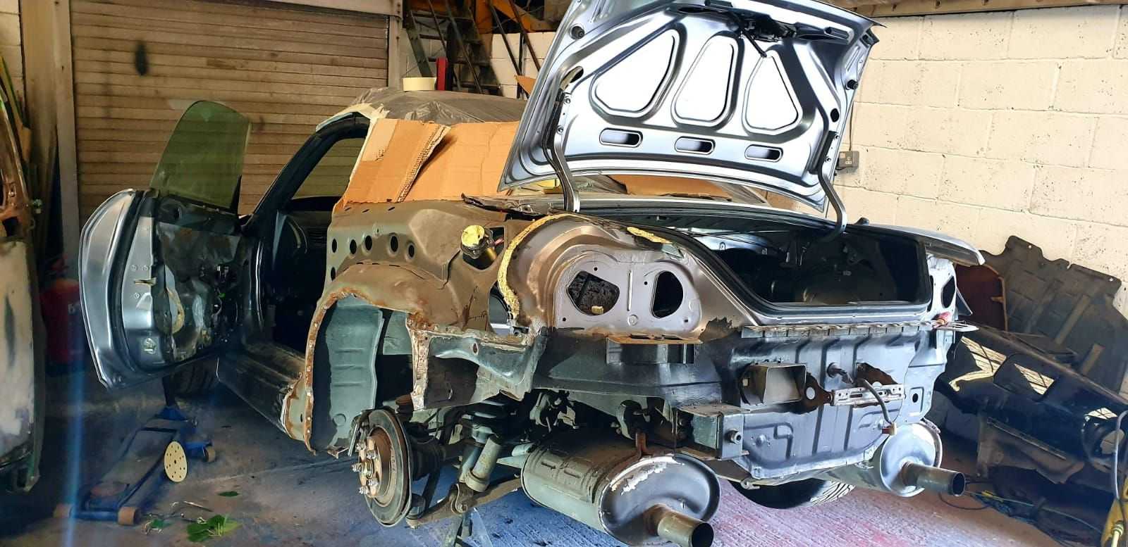

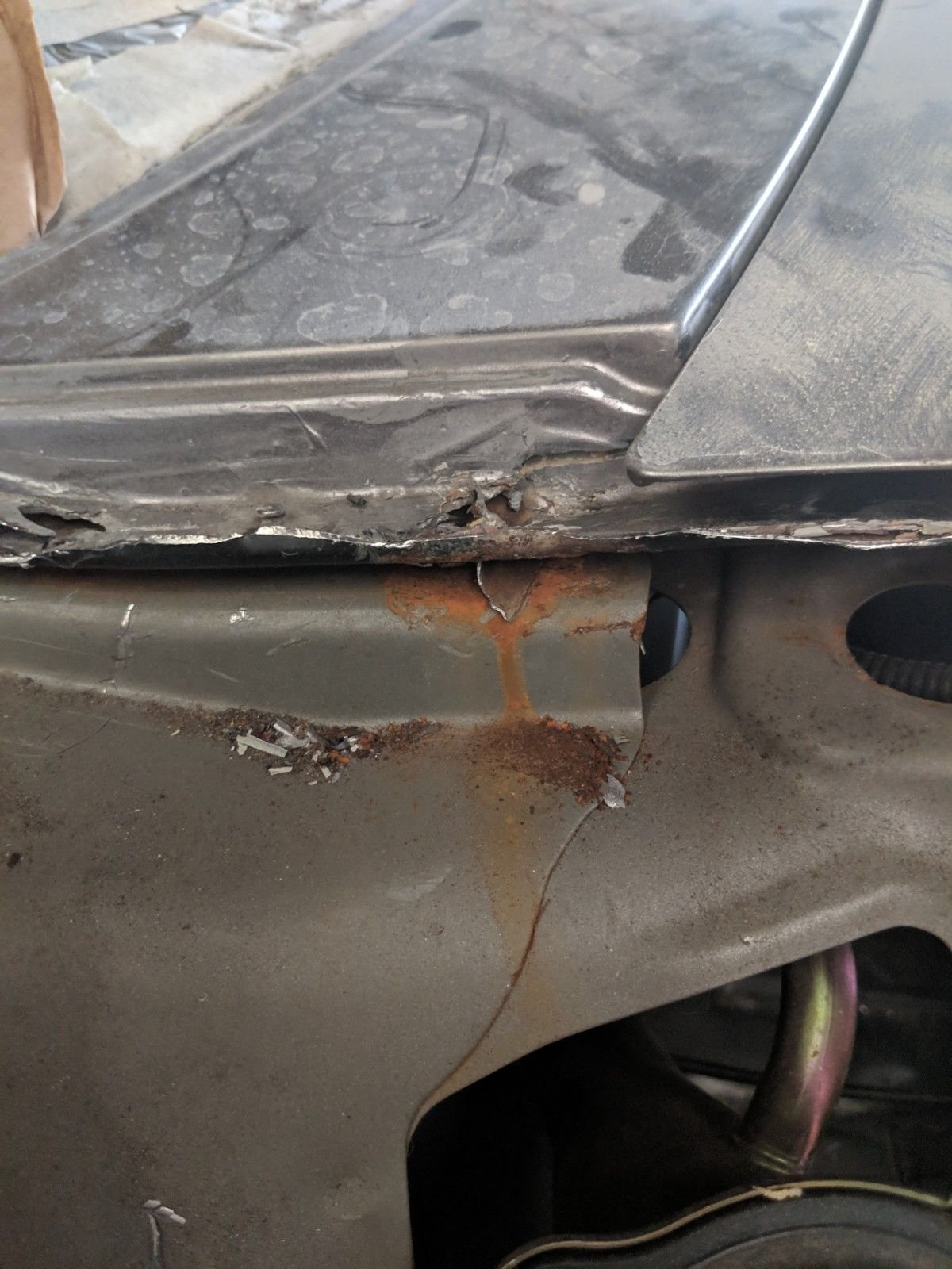

Old May 2, 2019 | 02:27 AM
  #30
Stoatmaster's Avatar
Joined: Jan 2011
Posts: 581
Likes: 72
Originally Posted by Stoatmaster
Mine was dripping slowly in, and then working it's way down across the boot floor (Where it was soaked up my the felt on the liner) as well as running down between the boot floor and the rear arch skin, running back around the weld, and ending up in the boot well.
Total bastard to find! Trith be told, once water is in it can go anywhere! You know if it's this problem by pouring water on those panels but not the roof/roof drains. Monitor the ingress of water into the boot and see if you get any drips/dampness. Don't have to strip the roof out then.
Just to drag this up is case it assists anyone in the future while searching.
I finally got around to dealing with the damage caused by the grommit, required the quarter being removed!
This is what an over tightened screw looks like;
Resulting in this;
