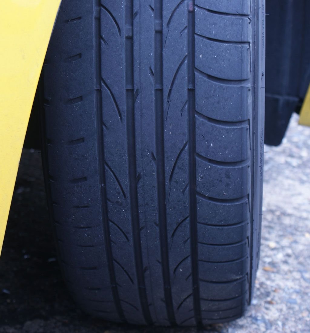

Would having two front tyres with inside edge wear like this fail an MoT? I suspect if I have to ask the answer is in fact yes

I think you will be ok:-
"A minimum of 1.6mm in a continuous band throughout the central three-quarters of the tread width, throughout the whole of the circumference"

Who cares?
I'd not like to drive fast in a downpour on them.

I think you will be ok ..... but only just.

Those tyre will pass but as mentioned you need to get them changed asap

Yep perfectly legal.
"Each side of the central band of the tyre can be devoid of tread (ie.

swap sides before you see the reinforcement....

Mine recently passed an MOT with tyres like that

Cheers for that folks. I'm off to see a friendly tyre fitter in the morning to see what he thinks and to get some prices for a new pair of fronts.
Not sure it's worth getting them swapped round plastic91, but I know what your saying. If only I got this done a few months back I would have gotten a bit more life out of them.
When it comes to tyres I'd rather be safe than sorry
It's okay Nick. I don't/can't drive fast in the wet.
