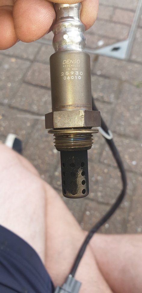

Old May 2, 2021 | 01:53 AM
Jayc87's Avatar
Joined: Mar 2019
Posts: 256
Likes: 38
From: Rayleigh, essex
This the part number of the denso sensor im running.
will research this part number when i get back on the wifi at home later..
Old May 2, 2021 | 02:57 AM
markforrester99's Avatar
Joined: Apr 2012
Posts: 1,762
Likes: 42
From: Hertfordshire
Go to lings honda parts, put your registration in and get the OEM part number for the sensor. Then search that part number and you will find O2 sensors that match the OEM part number. You might find you have actually got the wrong denso replacement sensor
