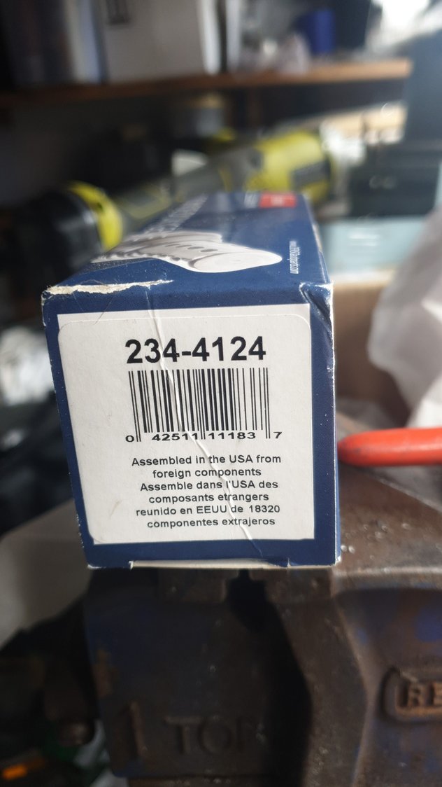

Home now, i kept the box the denso came in.
Appears it is correct..
I do have the oem sensor. Will check that..

I managed to find the o2 sensor is made my NTK from factory not denso.
ordered one from rock auto which it even states as oem sensor.. fingers crossed it works.
