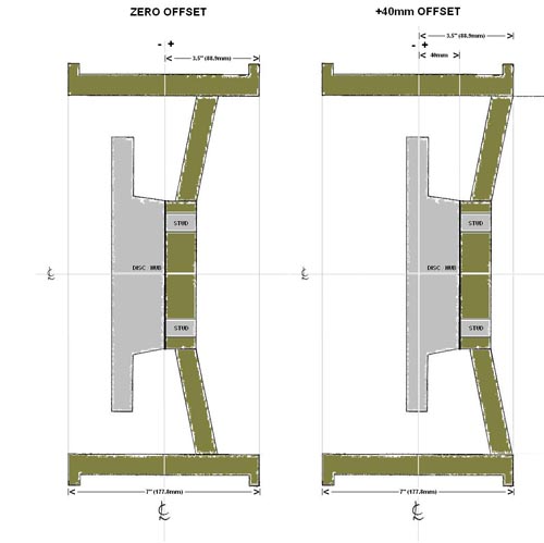

offset = basically how far the wheels sticks out. less is more, more is less

OK so what is the S2K offset then as the two sets shown above are very different?

There is no 'S2000 offset' unless you are referring to stock wheels. Offset is how far from the center line of the wheel it mounts on the hub. You then have to take into account the width of the wheel, and because the wheel well isn't square, the diameter of the wheel.
If you can't get fitment details from someone with the exact same wheels you need to find someone with wheels of a similar size. Ie, if you find someone with similar specs but higher offset and they say it rubs a little, you know that with a lower offset it will rub a lot.
