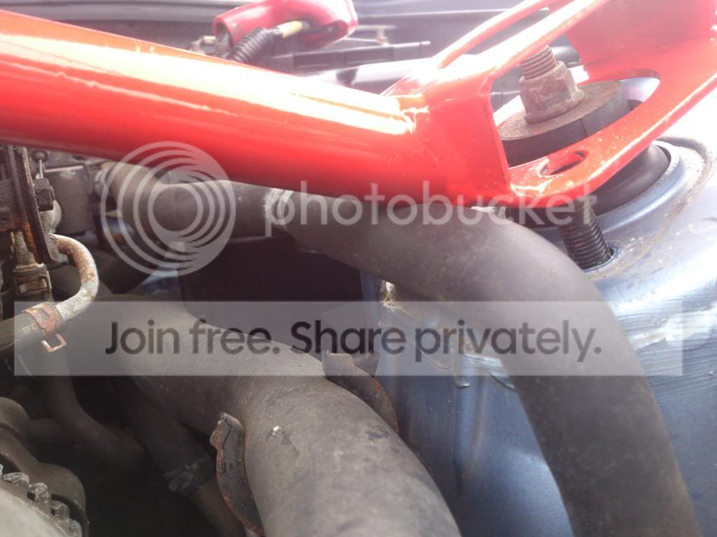

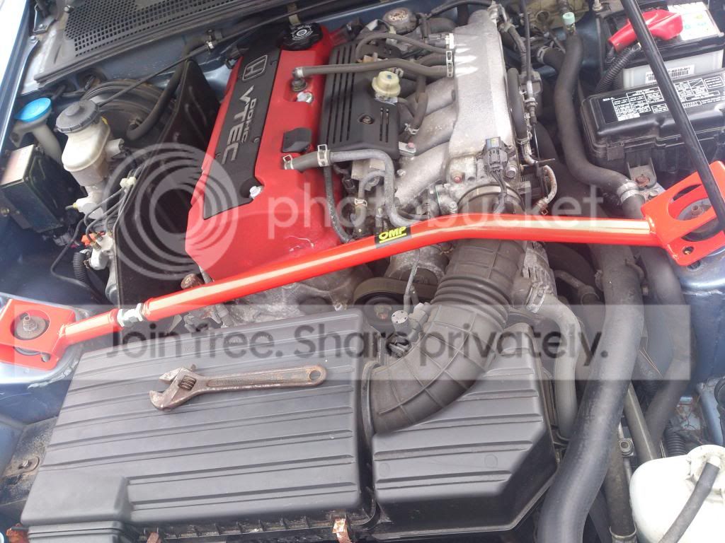

Basically need a strut brace as gonna have one declared on my insurance to make it cheaper. Now I know it does not make any difference on the S2000 having one fitted because of the double wishbone suspension but it makes my insurance a hell of a lot cheaper. Right so recently brought a OMP one for my 2003 s2000 however it would not fit because of the air con pipes being in the way.
Any of you recommend one that will actually fit?
Any advice would be appreciated, Or if there is a way that the OMP will fit? and me and my mechanic friend are just bring stupid but I honestly cant see how.

I've just fitted a Js Racing one and had to push that pipe down slightly, but not as much as you've got there.

There is a little silver bracket holding the air con pipe in place. Remove it and you'll be able to manipulate the pipe out of the way.

was through Adrian Flux. Declared I had a strut brace and it dropped my prem from like 1600 to 1000 . Yeah tried the bracket trick, Could get it to fit that way but the air-con pip is left resting against the strut brace, under a lot of tension against it. If I was to do this would be worried that it would break. Sure it wouldn't break under the increased pressure from being pushed down so much.
