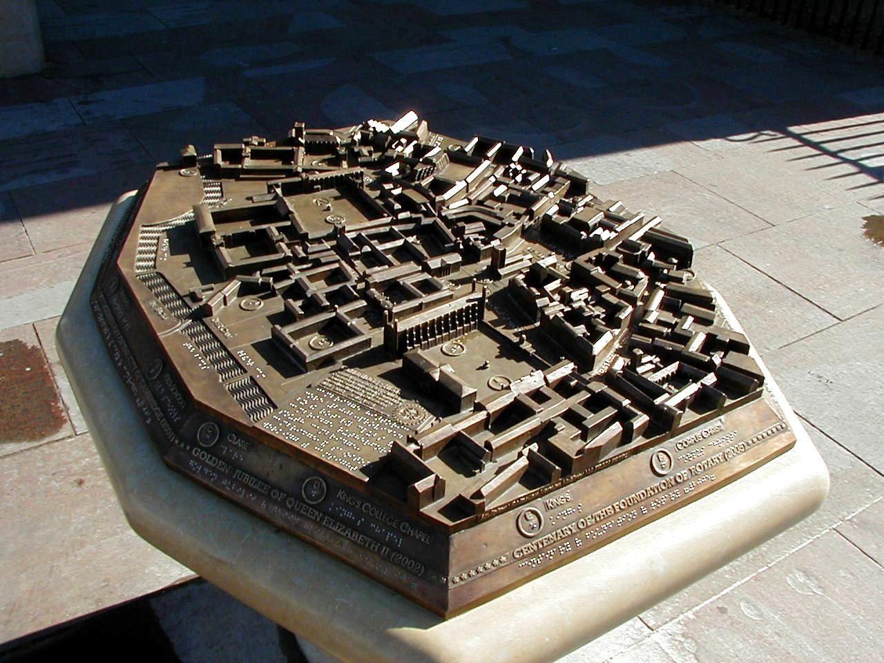

A tactile model (if you are interested)

Tell me more about what the tactil model actually is. What I see looks impressive but im curious to ind out more.
