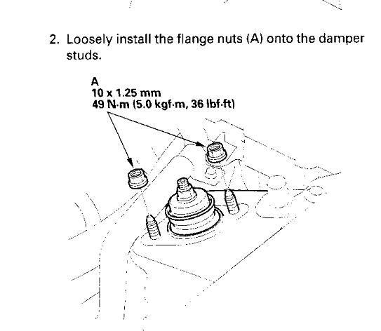

Just about to fit a suspension top cross brace,anyone know the torque settings?

49nm

No probs.
A pic with the Nm and Ft Lbs settings:
