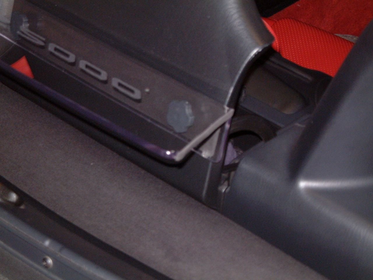

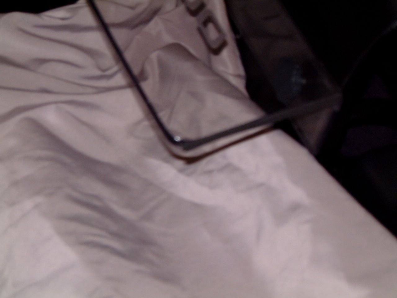

I have the answer to your problems I have a Muz screen (or is it Ricks I am not sure) it is 7/8 one (I will post a pic tonight but I am at work at the moment). Anyway I got some little rubber feet for the bottom of chair legs etc, etc from Hobby Craft. These, like your rubber stoppers did not last very long and popped off/ moved when closing the secret compartment after a while. So I went looking all over for a solution and again Hobby Craft came up trumps. They sell adhesive backed foam (they are for kids to make pictures with and come in loads of colours including bright red for those with a full red interior). Anyway I took the screen out of the car and measured the width of the plastic screen and then cut 2 long strips off the black foam. Simply removed the backing paper and applied to both edges of the screen. Works perfectly and has some give in the foam to stop shatter points. I have used it for serveral months although not in substantial heat but should be fine. I also applied a strip to the bottom of the screen where it is attached to the secret compartment stopping it scratch the plastic lid and the underside of the screen. It also quietens it down when driving top down over rough or uneven roads. You will notice how quiet it is afterwards I can assure you. The rattle was so annoying before that I would shove something down the side to stop it moving before I broke something after being driven to distraction with the noise. If I did not find this solution then I might have got rid it was that bad.

Right I have taken some pics they are not brilliant - black against black does not show up very well . basically the adhesive backed black foam is along the edge of the screen. The pics show the compartment lid up so that you can see the edge.
I think a sheet costs 79p
Cheers Rob

BTW.........looks like your screen is a Muz or Aus one (can't remember who does them) as it's fixed and does not need the OEM bracket. Mine is a Rick's one that fits into the stock bracket. At the end of the day, both solutions should work for both screen types!.

Its a muz one!
Looking at the installation destructions for my Aus one its all in the gluing. It does not mention any bump stops of foam strips. It makes a lot of emphasis on ensuring all the touching surfaces of the bracket and the screen are well glued and clamped whilst they set. Redid mine over the weekend so I will let you know shortly if it has worked!
