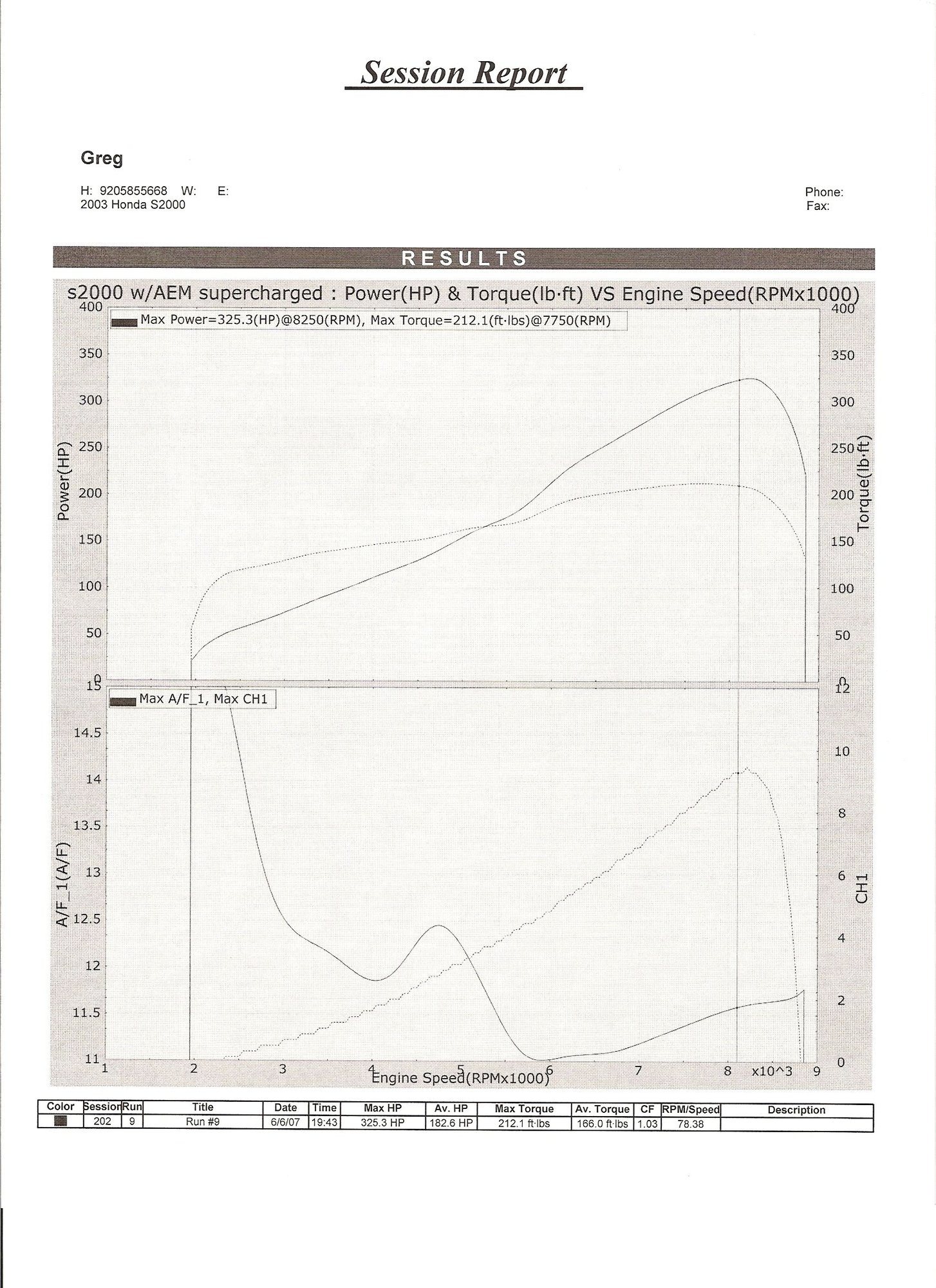

1. That AF curve is a little, um, "peak-y" Can't you smooth that out with the AEM?
2. Why only 8250RPM? Why not "push 9?"
Old Jun 7, 2007 | 03:40 PM
  #45
pushin9's Avatar
Joined: Nov 2004
Posts: 2,617
From: WISCONSIN
1. It just looks so peaky because of the scale on the graph
2. We also did a pull to 9,000 and got 327.5whp but I don't have that printout
This is from a Dyno-Comp dyno. He said this dyno reads lower than all the other kinds of dyno
