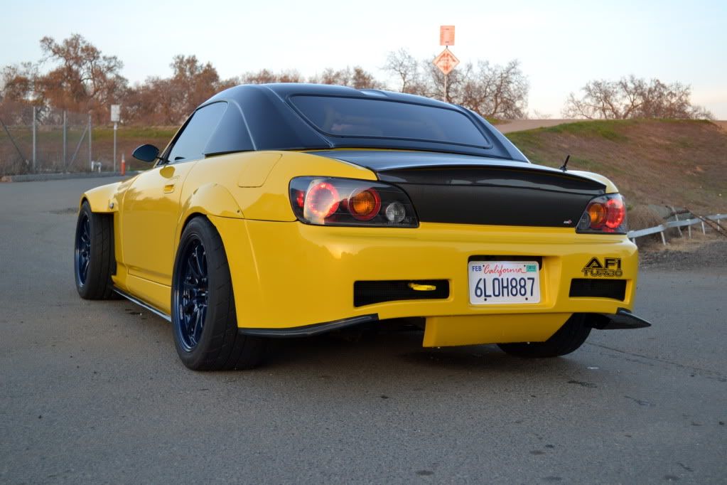

17x9 +22 will be super aggressive on a stock body s2k. Im running 17x9 +22 x4 Ce28s with 255/40/17 RS-3 with J's Racing front fenders(40mm wider) and ASM rear over fenders(25mm wider)
