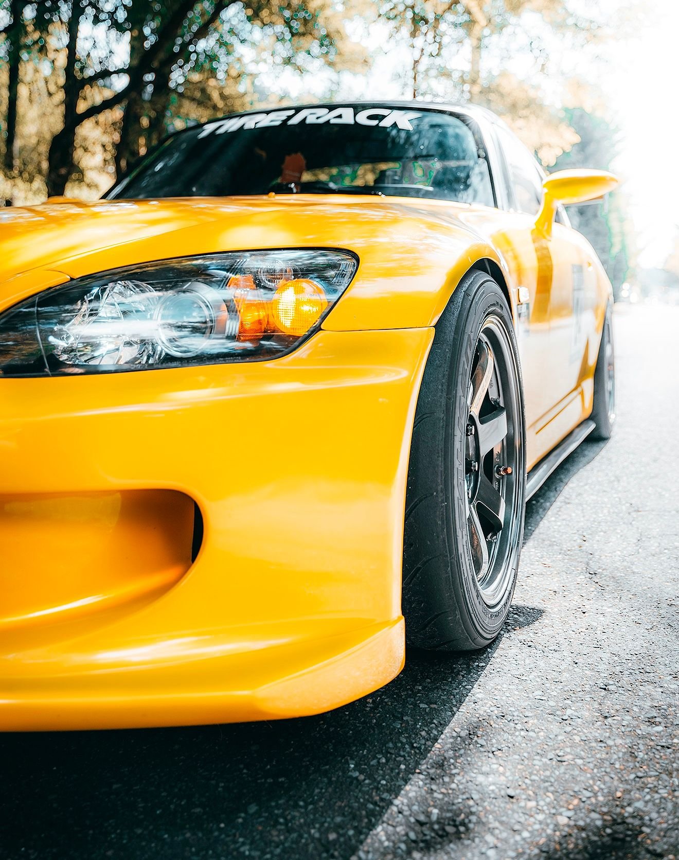

255’s will fit no problem. I track my car and don’t experience any rubbing. Just make sure to roll your fenders and do the typical tab relocate for the rear. For the fronts you will need either offset bushings or lower ball joints, I personally run J’s offset joints with -3.6 degrees of camber. The rears should fit fine. Here’s a picture of my front for reference
