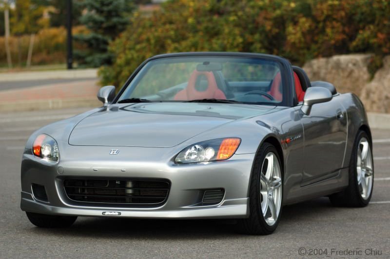

This is what im Running. SSR GT1 and Yoko ES100's
18x8 48mm offset Front - 225-40-18 tires
19x9 55mm offset Rear - 255-35-18 tires
Not deep dish, but if you can find deep dish this size then
No rubbing problems at all

seeing how tugz s2k's looks with the lower offsets makes me doubt if i went too high +50/+63.
more than likely, i'll need springs to get the look. anyone have suggestions on alignment camber settings?

s2000craze, your wheels are the perfect size. Offsets like TUGZ' make lowering more difficult
