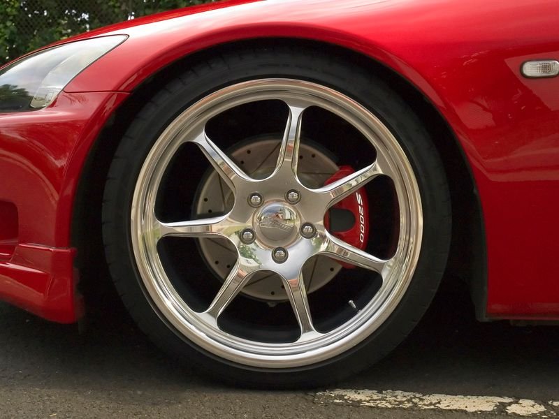

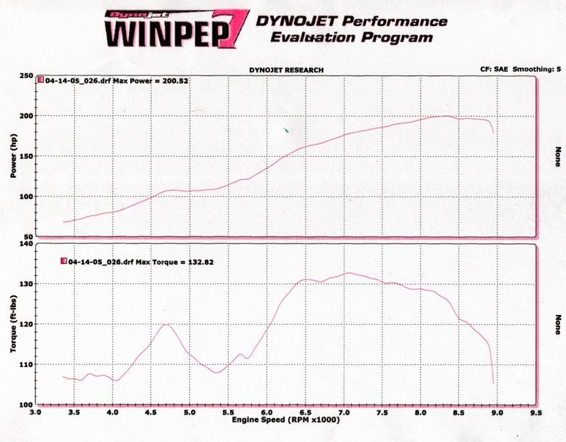

hahnn002's Avatar
Joined: Jan 2004
Posts: 2,109
19" wheels work great, just make certain you have the proper offsets. I'm lowered on Megan coilovers, and before that I had Eibach springs. I've only had slight rubbing when in a heavy turn and hitting large bumps on a canyon road I like to drive. I'm on 225/35/19 front and 265/30/19 rear with Goodyear Eagle F1 GS-D3 tires, but the photographs were taken when I had Nitto 555's in the same sizes. I use the Goodyears now for their excellent wet traction because I live in Hawaii.
This board has a lot bias when you say 19" so just go with what you like. You'll hear a lot of things like this:
"just prepare to lose around 50hp and about 200ft on braking distances.."
but these comments are made without hands on knowledge or scientific backing. They use big words like "rotational mass" because others have, but hardly know what it means let alone whats its actual effect is in your application or how to calculate it. I didn't loose ANY hp on the dyno, in fact I had the best run out of half a dozen other S2K's during a dyno day, and like the other guys I just had an intake and exhaust at the time.
Far as braking distance goes, I had another car run me off the road at 75 mph when they changed lanes into me. My brakes worked incredibly well and if they hadn't I would have been split in two by the narrow end of a concrete wall.
Not all 19" wheels are heavy, ugly, chrome, power robbing monsters. Mine happen to be one piece forged aluminum, and with the rubber mounted they weigh the same as the stock wheel/tire combo. That shine is polished aluminum, not chrome. Just do what you're doing now, research what will work and pick a wheel that meets those specs and pleases your eye. Just be carefull with who/where you get your info from because not everybody here is an expert, and that includes me.
Just my 2 cents,
-Nate

Hi Nate!
Usually I am not a fan opf 19" on the S2000 buy your wheels look very good - whicha re they?
