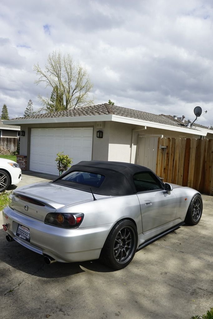

Hey guys I just recently purchased a set of CE28 mounted on Dunlop's 255/40 square set up and the wheels are 17x9:F and 17x9.5:R offsets are unknown but they look like they're around the +38 theyare poking out. I am sitting on buddy club coilovers and i wanted to see what camber setting would be ideal for function both street and track w/o modifying the fenders too crazy. I'm thinking of doing a pull at the most.

Agreed, those look like +38 to +35 offsets. The rears you can get to tuck with some finite trimming/rolling and bumper tab relocate and about -3 to -3.5 camber which isn't ideal for the street but it will work. 245 would be better to be able to dial the camber back a bit to around a more ideal -2.5. But the front is going to be the real issue. Your maxed at about -2 with your ride height and stock camber adjusters. I wouldn't run more then that on the street anyway. That said, Id remove the front tires and sell them before you cut them up anymore and ruin your front fenders, or save them and run in the rear when the current rears wear out. Id get a pair of 235/40's on there and gain some leniency. 235/245 stagger on a 9/9.5 is reasonable. Or if your into pushing it, keep the 255 in the rears and gain some camber wear and poorer street performance.

Sell those and buy wheels that actually fit. Might lose money but it'll save you time and headaches, and you'll be able to set the car up with fewer compromises

The offset should be stamped on the back of the wheel face. Most volks have a sticker with the wheel specs on them as well in the barrel. The fronts could be +45 (or in the 40's) the rears looks like they are in the 30's. I agree on running a 245 (or 235 even a 225 isn't horrible but it will be a bit stretched) in front that would at least give you a little more space. I assume your fenders are already rolled flat and tabs relocated but yeah you need more camber. First take the wheels off and figure out the offset. You can try to pull the fronts some but it starts getting really hard to keep it looking even. Junky's post has good camber recommendations.
