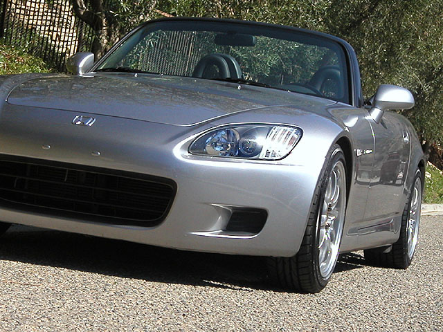

The OEM AP2 Bridgestone RE050 tires in 215/45/17 and 245/40/17 will be a nearly exact match for diameter and tread width. All other 215 front tires will be significantly wider, most 245 rears will be narrower. Diameter varies from brand to brand, just be aware that even a small difference in diameter can be felt because our cars are low on torque.
www.tirerack.com shows measurements for most tires but they aren't always accurate.
Here are pics, the RE050 are on CE28 17x7.5 +50 and 17x9.0 +63, the S02 are on OEM wheels.
