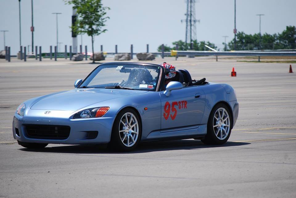

I'm running the TSW Interlagos 17x9 +63, 255s on all 4 corners, lowered on Ohlins DFV. I rolled the fronts. ( I was burning through the plastic buttons on the tabs with AP2 wheels and 225s on the front, and as mentioned above, had rubbed the lip between the tabs over bumps with the wheels turned.)
