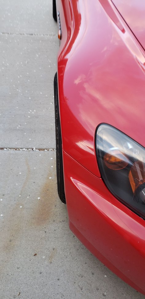

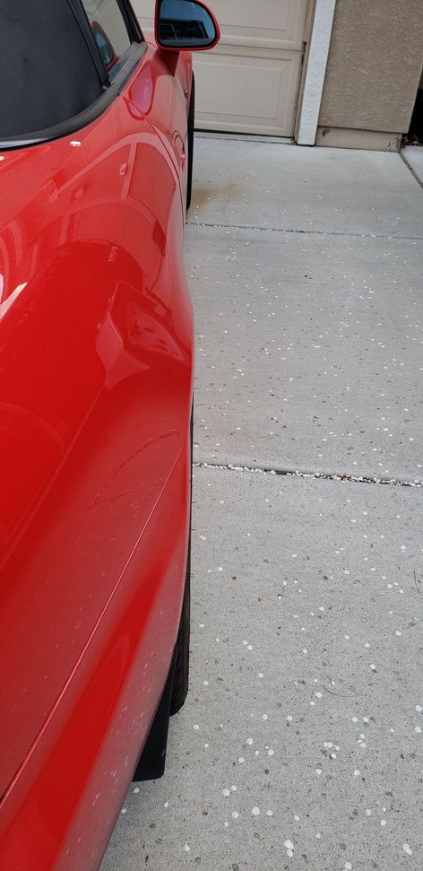

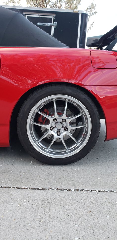

Love my big lip on PF01SS. I have PF01SS 17X9 +48, I run 245 all 4. The rear look flush so 255 should be ok. Up front is poking out beyond fender so with +60 and 255 might be ok.
My car is lower and fender rolled.

Can you post photos of your setup, especially the fronts?

Front
Rear flush
