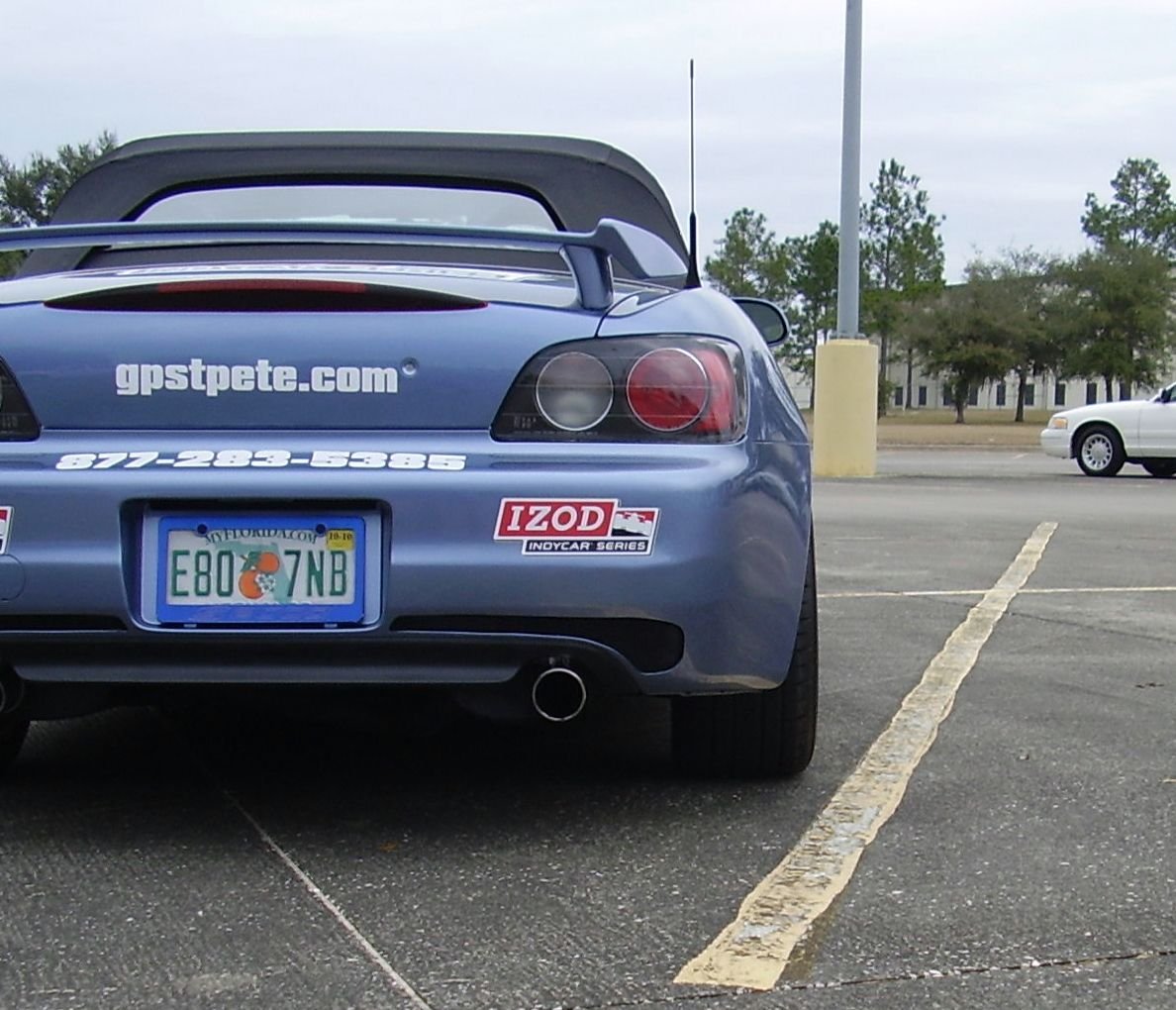

I need some input/help...I have a set of 17" Simmons 3 piece wheels that I widened. I replaced the outers on the rear wheels with a 1” wider lip. The rear wheel is now 17” x 9” +57 offset
After the alteration I put the 255-40-17” tires back on and they are a bit stretched looking.
I am not happy with the look of the tire and would like to maybe go to a wider tire to fix it
How much trouble am I looking at doing this, will my car look like crap with wider tires, should I go back to my old outers?
In hindsight I should have ordered a ½” wider and not the 1”

Looks good to me Ben. The stretched look would help me clear them easier on my lowered car. But in your case I suppose a wider tire wouldnt neccessariy rub. Good luck. Hopefully Jim chimes in soon

Thanks, I talked to Jim a bit today about it, I may go with a new set of 265-40-17. I may have to roll the fenders just a bit and use UK spec aliment.

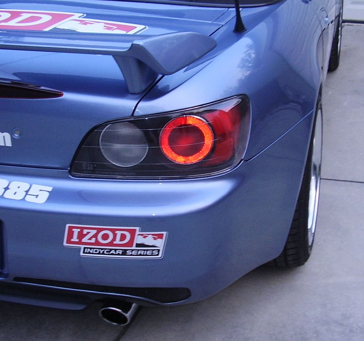

Mounted the new Bridgestone Potenza tires today and they look good to me I measured my offsets again with the tires off this time
The front wheels are 17" x 7.5" +48 offset
The rear wheels are 17" x 9" +57 offset
Tire size is front 225-45-17"
Rear tire size is 265-40-17"
I used a 3 mm T1R Forged wheel spacer on the front so that the front tires would track better with the wider rears. I guess this would make the fronts now a + 51
Going with the 265 in the rear took care of the stretched look I was getting with the 255 but, I will have to roll the fenders a little because, the right side did rub on a hard corner.
My alignment is within factory US specs right now but, I’m thinking about going UK spec, what do you think?
I will post better pics after I clean the car and wheels.

Looks good Ben. I like the looks of the tire and it does square up better than the 255. They look nice being that flush. I used 20mm spacers to accomplish the same on my AP2v2s.
A little more camber than UK spec wouldn't hurt you. I'm running 2.8 and no wear problems yet on my 17s. Not saying you have to go that aggressive but it wouldn't neccessarily shorten the life dramaticly. Yet the UK spec before you go to crazy with rolling/flaring. Might accomplish what you need.
