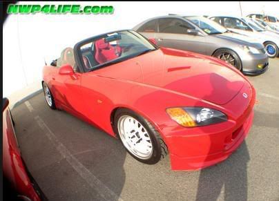

my old setup 16x7+35,16x8+35.
205/225 tires

what size tires are these on the car front and rear
