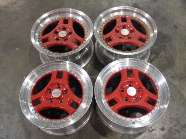

Wondering if these wheels would fit. I'm pretty sure the front would fit, but how would the rear look? I'm fine if they stick out a little bit but hopefully it's not too much? I'm on stock suspension and I am able to roll my fenders if needed. The sizes are:
17x8 +45
17x9 +38
Also if anyone has pics of these wheels mounted on a s2000, please post.

They should fit with rolled fenders and a combination of stretched tires and negitive camber.

hrmmm not really looking to mess with camber. What size tire would you recommend for these wheels?

245 with rolled fenders.

I was looking at ordering some SA3V2's in almost those same offsets. I was planning on running 215s in the front and 235s in the rear. If silentdancer says a 245 would work i would go with that.

235 if you dont want to mess with camber if you are lowered, but since you are at stock height you can pull off a 245

+38 is going to stick out and you will need big neg camber.
Here's a +38 on 300gt's car. (not my photo - will remove if asked)
