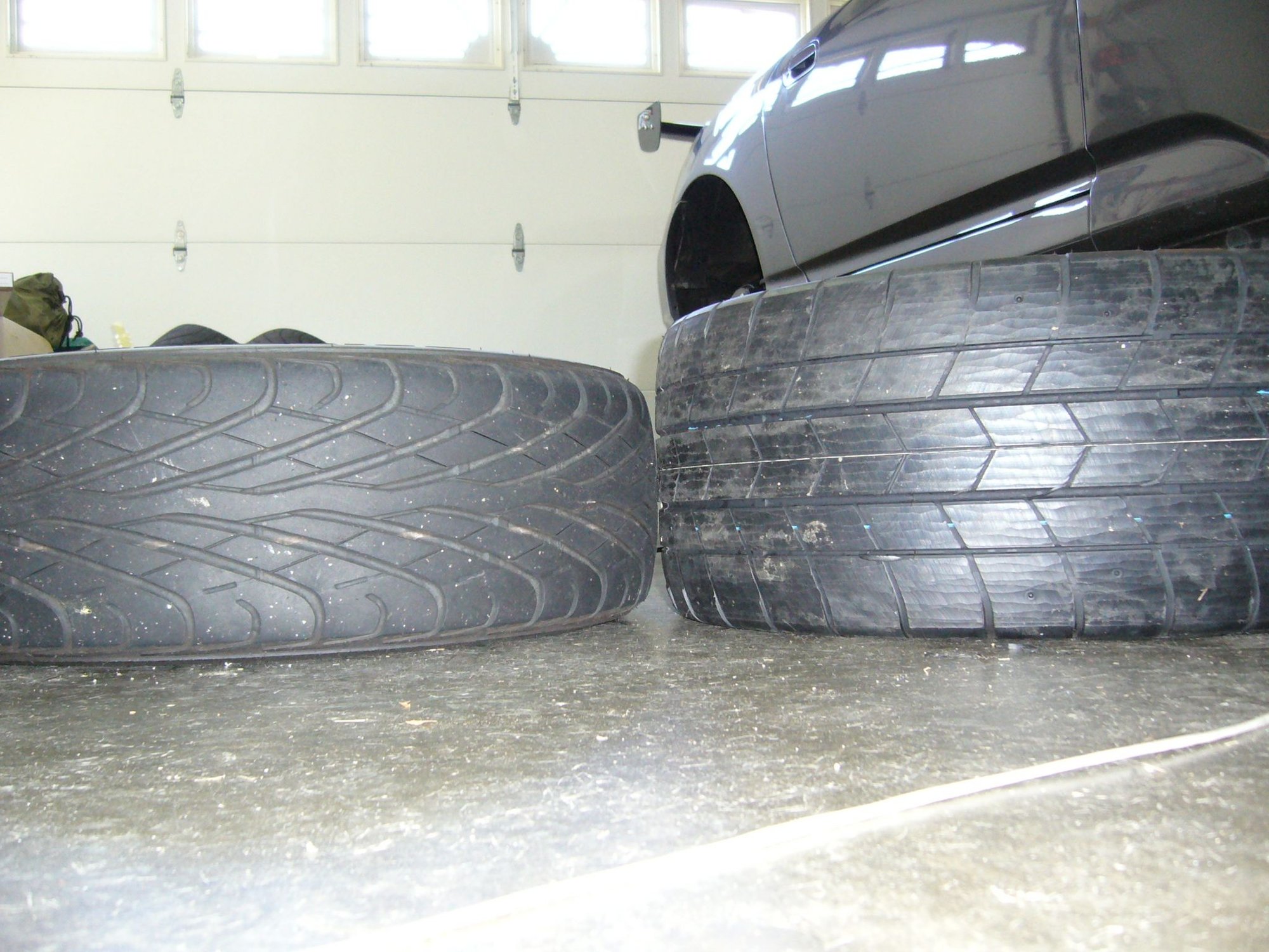

I run rear AP1 wheels on the front and CE28N's on the rear. Yes, i had to have the wheel opened to fit over the hub in front. I run RA-1's- 245/45/16 in the front and 255/40/17 in the rear.
I lowered the car in the rear a bit more and changed the angle of attack on my wing. I was actually understeering. Too much angle, too stiff on my Gendron bar, incorrect pressures, or all of the above led to the understeer. I was expecting to hang the rearend out a bit more. Previously I had been running 225/245 on AP1 stockers. Braking did seem to increase.
Turning lock-to-lock with the oem rears up front and having the Gendron bar leads to inner rub. Doing this at any speed would be bad. Also, the front tires have nothing to do with the speedo.
Here's a pic showing the difference between a stock S-02(205) and a RA-1(245) for the front:
