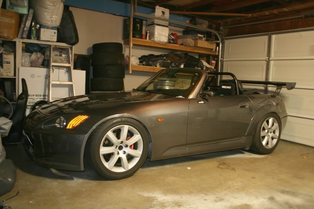

you are correct the bore size is a tad bit smaller but it will still work. you just have to make sure that when you are installing the wheel that it is evenly torqued down and that the wheel sit flush on the face of the rotor. i would also suggest that if you dont bore it out that you not race the car at the track at all.
here is what the Z wheels looked like on the s. this is with the oe Z tires though:
