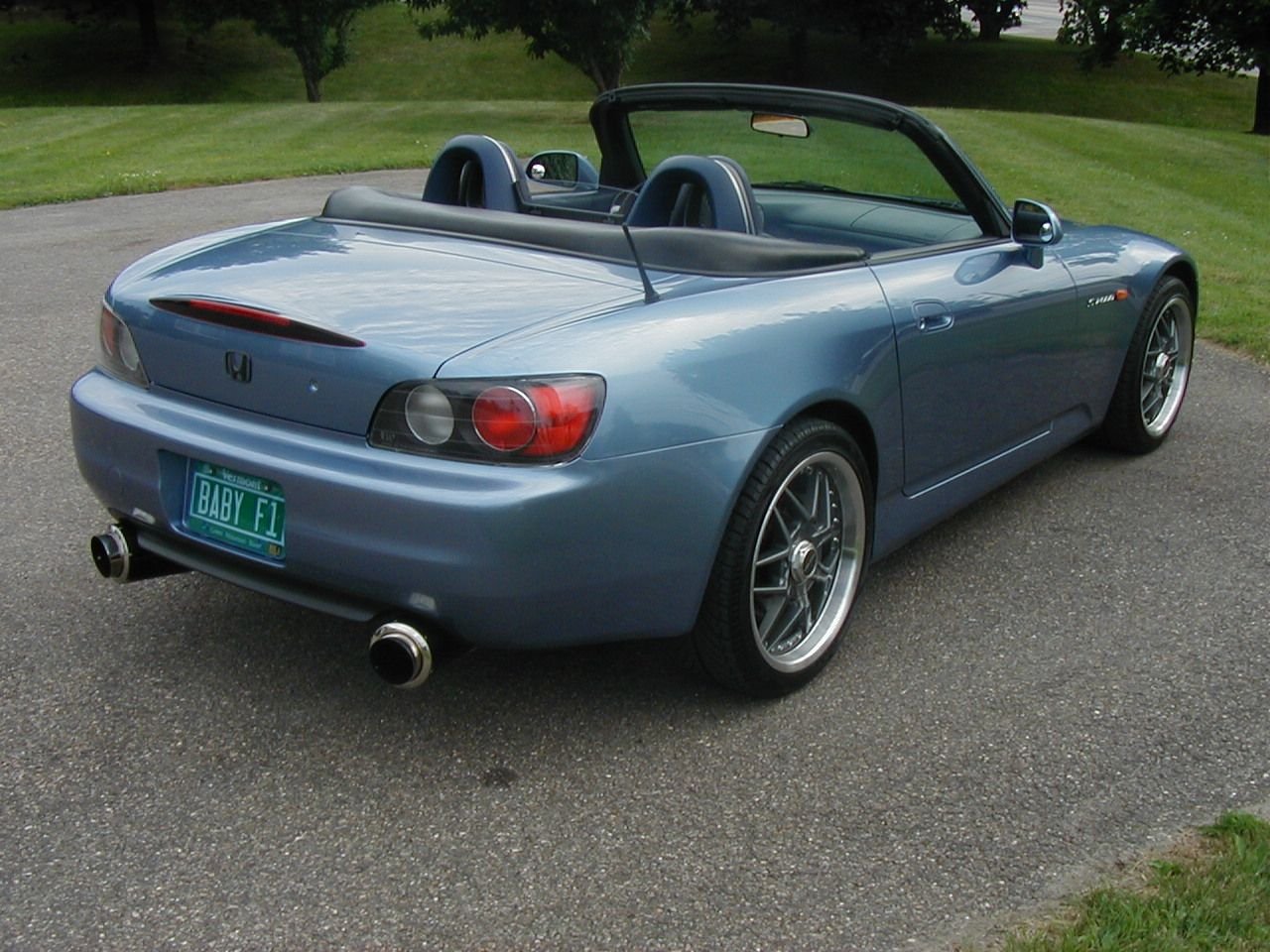

They list them based on the original 205/225 sizes without consideration for the construction characteristics of the OEM S0-2. Bear in mind, most of these large market tire/wheel shops will only consider tire sizes and bolt patterns when determining appropriate fits. Tire Rack is the exception. Nine of of 10 shops you speak to when discussing S2000 tire and wheel info have no idea the S0-2 tread width is that of a 245 OR the fact that the OEM offsets are 55/65 front to back. If you fit an ET40 16x7 wheel on your S2000 (in most cases, based on say, a 16x7 wheel) with a 205/55/16 tire you will go outboard .6 inches, increase tire track by more than an inch (1.18 I believe) and add 15mm of additional clearance between your wheel and the strut housing. The outside edge of the wheel, as I said earlier, will extend an additional 15mm (.6 inches). You can do it, but you probably wouldn't be able to lower the car unless you went with a smaller diameter tire on that wheel.
There is a difference between not recommending that wheel based on performance and not recommending it based on asthetics. Here is a pic of my car with a 205/45/17-inch front tire on a wheel that is 17x7.5, ET40. The rears are 18x7.5 ET42. Not for everyone, but these Blitz-style Velox VX-K gunmetal wheels have worked fine for me. However, I'm taking them off though in the spring because I'm going with a new tire/wheel combo. 16-inch 13.5-lb wheels with new 19.5-lb tires. The 17-inch Velox's weigh 23-lbs in the front and the 18's weigh 25-lbs. I'll be dropping some SERIOUS unsprung weight with this new combo especially since the tires I have on the car now weigh 25-lbs in the rear and 23.5-lbs in the front. Needless to say, with this huge weight loss and other goodies I have planned this spring, I'm looking forward to one quick S2000 this year.

I don't see anything wrong in that pic. Wheels look fine to me. But .6" is not that big of a deal.
