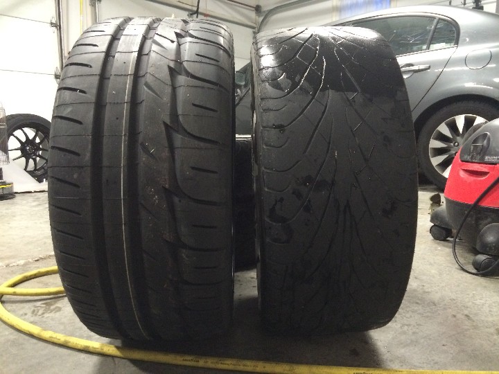

OK,the new wheels arrived from TireRack. I'm kinda sorta thinking those rears were about ready to be replaced...

I hope you're running max camber on the front (anywhere from -1.6 to -1.8 depending on the condition of your a-arms, bushings, and adjusters). it will maximize use of the tires and give better turn in. It will also give you better clearance (for reference, my track alignment is -3.0 camber all around).
And, make sure to bend the fender tabs upwards, else you'll definitely get some rubbing under hard compression at the track.
