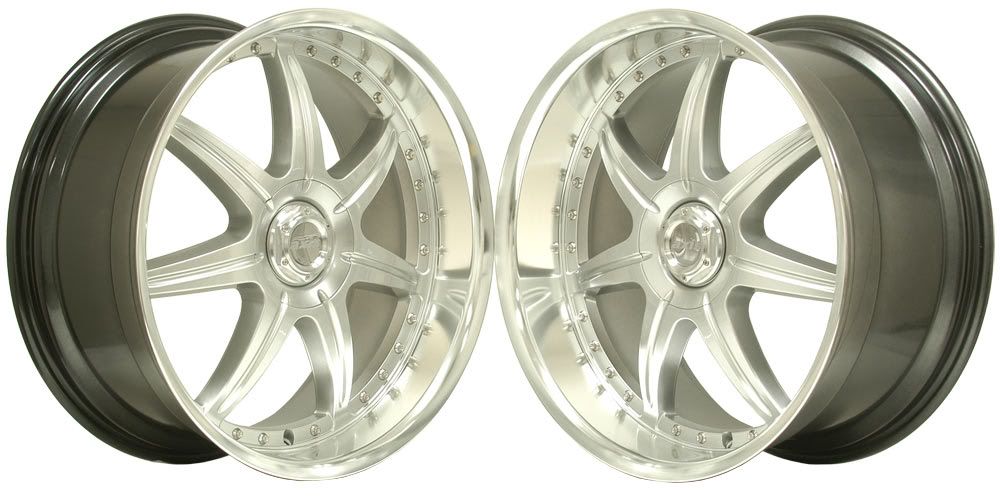

its a PITA trying to find wheels for my car.....
all i want is the axis se7en mod...18 inches, silver with polish lip.........
is there a staggered setup that will fit my car???
i got this pic off the axis website.and it seems like a staggered setup...but on the size options....didnt see anything...

This friggin topic has been beat to death.
In one of the forums there's a sticky at the beginning of the forum that tells you exactly what size wheels will and will not fit without rubbing. If you really want the wheels though, just buy them. You may have to run more negative camber or roll your fenders or trim your bumpstops, but if that's what you want then go for it.
Or get the size you need off of the sticky and have Axis make you a custom-sized set.

You would have to ask Axis if they have a set of wheels that fit the car. If they can give you the offsets and the sizes available I can tell you if it is going to work and what tires to use.
If I can help let me know.

i'm not really very knowlegeable about wheels...
18x7.5...........4x100, 4x114, 5x100, 5x114
19x8.0...........4x100, 4x114, 5x100, 5x114
20x9.0...........5x100, 5x114
20x10............5x100, 5x114
this is what i got off their website

You will also need to know the offset of the wheels. I will say there doesn't seem to be any staggered sizes for the car. The handling would not be as good as it is now.
