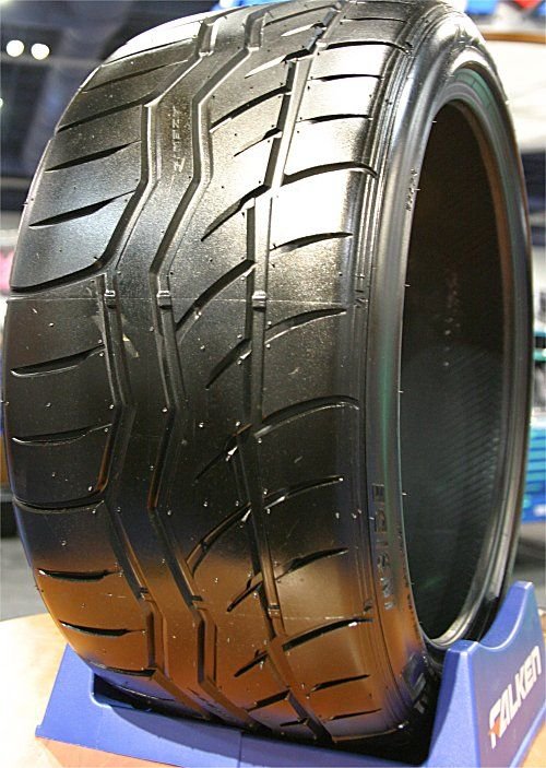

I emailed FALKEN Tire, and they have a new line of tires coming in the spring of 05. They will be producing an expanded size range which will include 225/45/17 and 255/40/17. I was told from talking to people that the AZENIS is a great compromise for R compounds. It is a street legal tire that you can drive down on too events without the worry of wet roads, while giving up little performance.
I saw this new line at SEMA this year and got a chance to talk to one of the reps. First of all, the tire looks really nice. Pretty much same specs as the current Azenis Sport (treadwear 200). One of the big complaints of the current Azenis Sport is that they get greasy for track use (ok for autocrossing). The rep immediately knew what I was talking about and said that this was one of the key issues they addressed. I'm planning on picking up a set to test it out since I'll be getting my wheels around that time as well.

The new Azenis do look cool
I have heard that they are supposed to work better hot than the current Azenis Sport...
